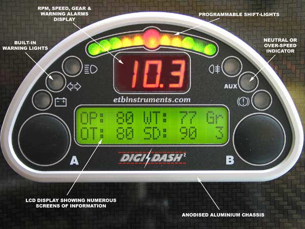

someone i know paid 3 k for a digi dash in the steering wheel but then they race pro cars ;)
