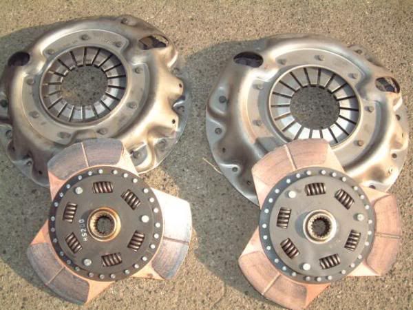

there is a nismo clutch for the cg10,im sure Amy could get one imported, Helix also offer a racing clutch for the k10.
having spoken to some ST owners they recomend Exedy clutchs for the ST and im using an exedy clutch in mine and it has no problem taking the power what so ever not even given the sign of slipping once
But you have at best 70lb/ft torque. Its a whole different matter when you have nitrous where you get a HUGE increase in torque (thats what makes clutches slip - not power). With Nitrous the ST had over 200lb/ft. It would slip a brand new clutch even with a Nismo plate.
160mm nismo one may be available, but probably cost more still.
I have two nismo clutches coming from japland at the moment,now I'm keeping one but would sell the other at the right price. . . .
