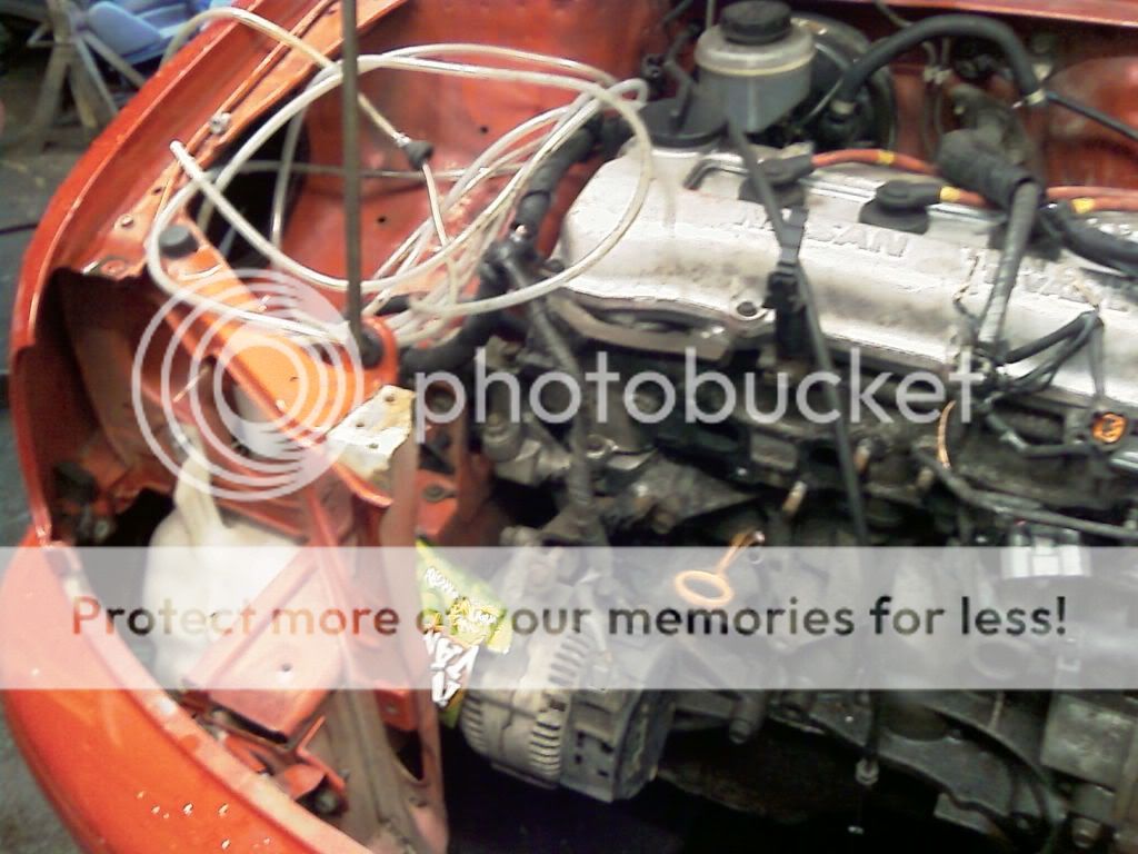

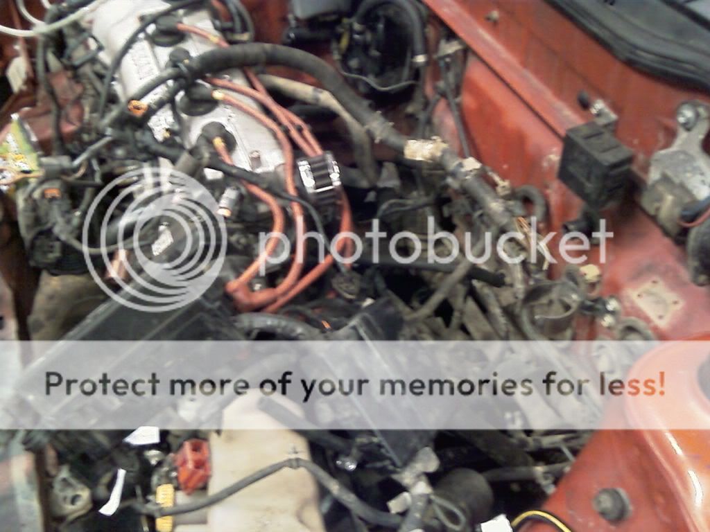

another update the throttle bodies are out of the window at the moment had a major set back one of the shims have disintergrated runied a bucket and made a lovely mark in my camshafts so gonna sort another shim out tomorrow and one of the cam caps broke too
ouch, the cam caps are line bored and numbered eh, but you should be able to lap a replacement one in, then check it with engineers blue![]()

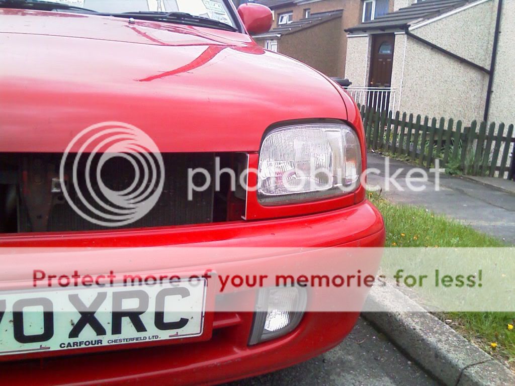

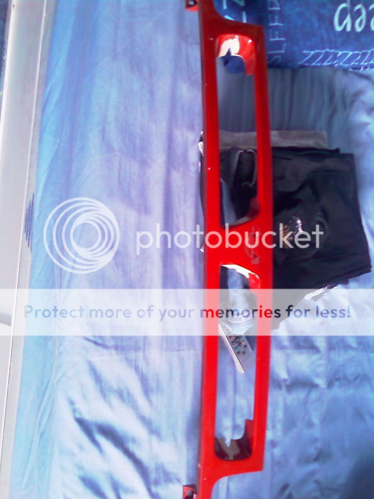

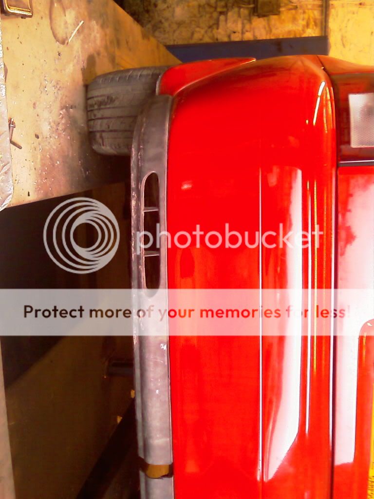

Splitter looks good, needs to meet in the middle though imo
