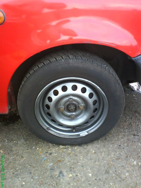

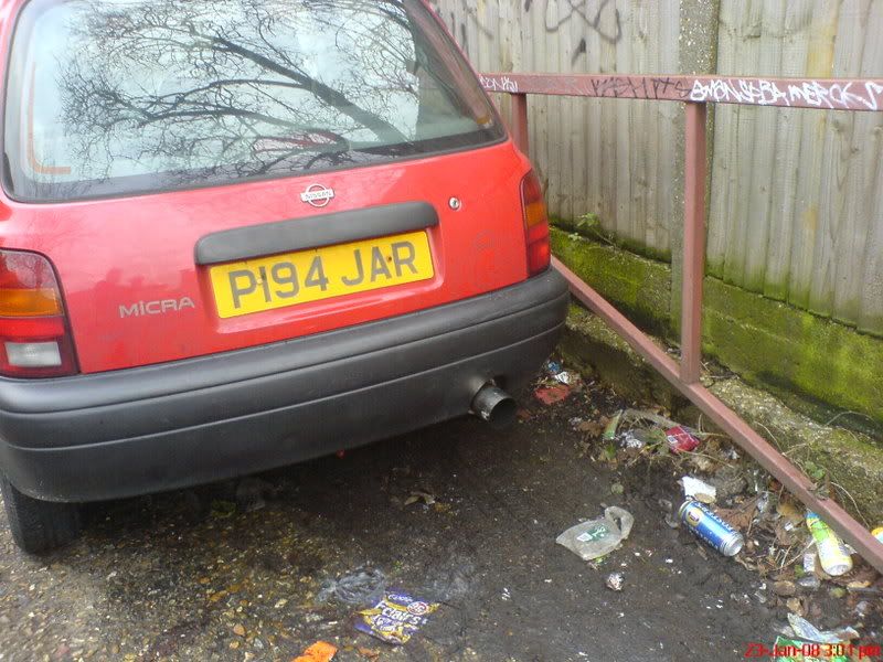

Lets start off with the pictures as I got it, the scrapes etc were done by the previous which really let it down but will be sorted soon as I have a new bumper and wing ready to go once I get them spray them sprayed and colour code the car.
I did decided to paint tthe steels BMW grey though as they were rusted up and looked nasty.

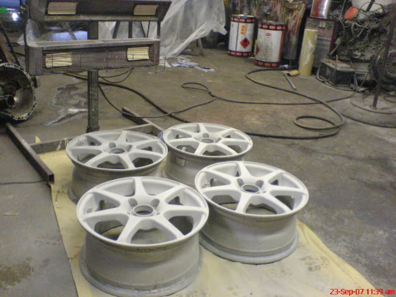

O.k sorry guys but i have been busy so no recent updates but I do have a few pictures to show etc of my setup etc so lets begin.

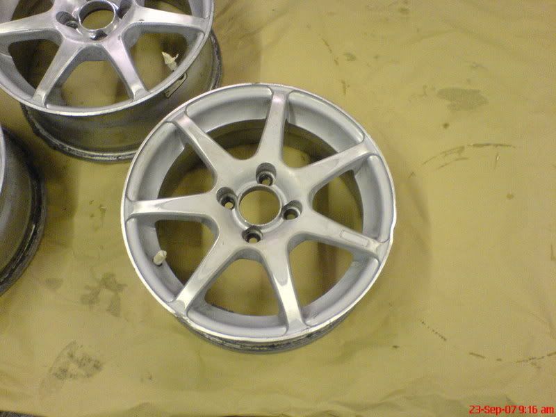

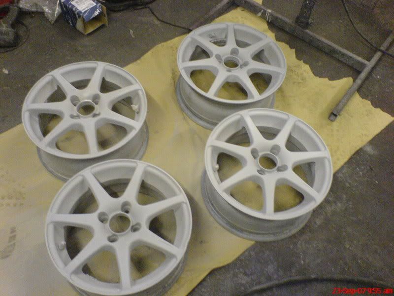

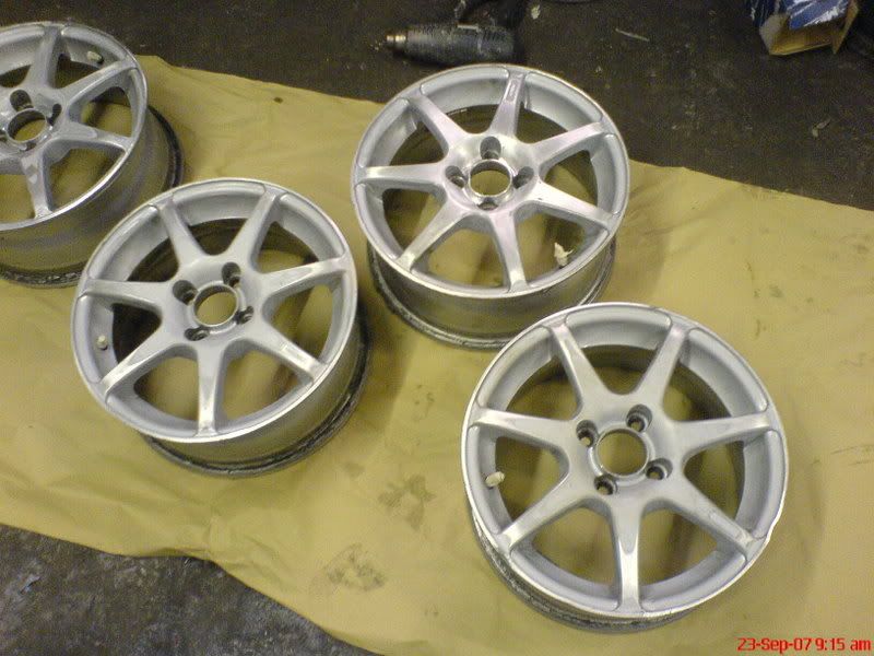

Just to show you guys my allows which I am refurbishing, had to grind them a lot to get rid of the curbing which the previous owner made.
Primered and looking good
The final coat is yet to be done lol, my bro is the sprayer and he has a lot of work right now so I have delayed the spraying of them. Gonna be a metallic bronze with some pearl in it.

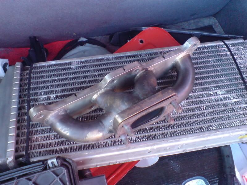

My manifold (thanks to Davey C) This is the same one that was use din reverbs car in Australia.

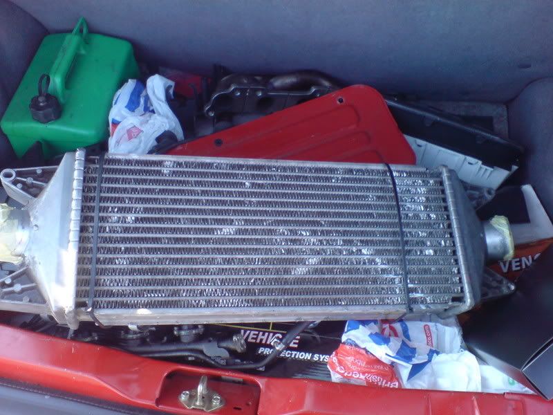

My intercooler, has quite a few bent fins which I will try and straighten out as much as possible.

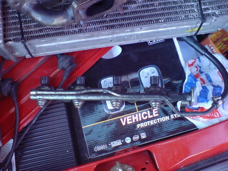

The Injectors from the primer (thanks to Davey C again).

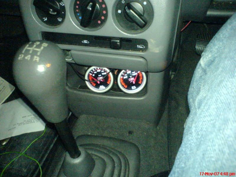

My oil pressure and oil temp gauges in thei temporary positions. Considering fitting them flush fit against the back of the dash if there is enough space.

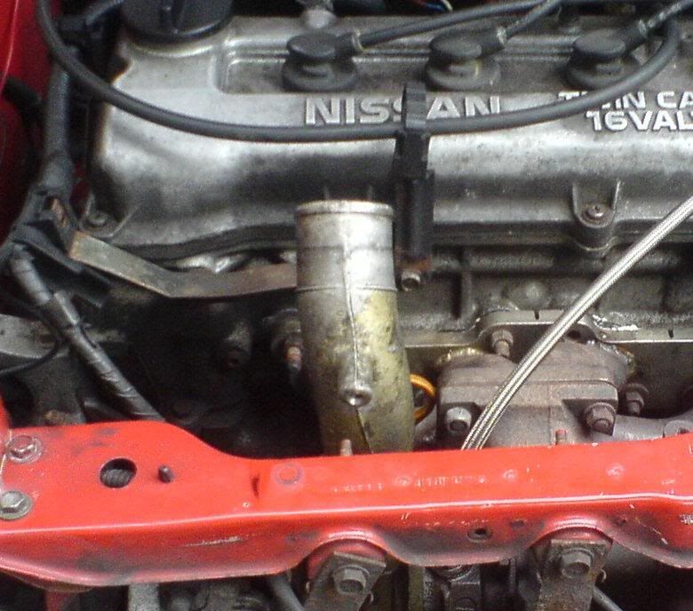

Well progress wise I have fabricated the downpipe up to the sump and 90 degree bend will have to weld on a bung from the lamda sensor as well.

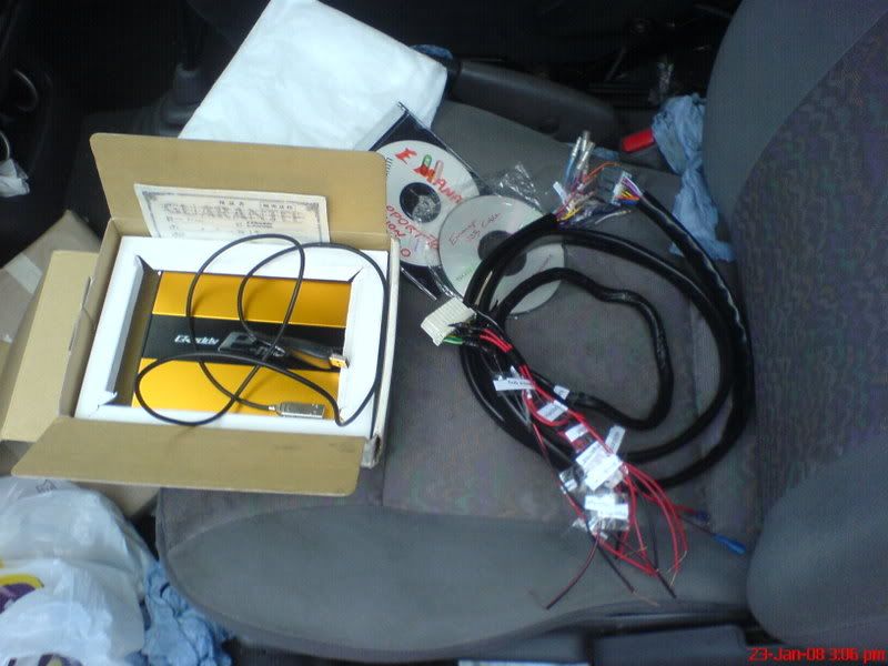

The emanage
checkout my custom main harness for it as it didnt come with one so i made one myself from a plug i had, this is the total kit for the emanage injector harness, main harness,ignition harness and the pressure sensor kit (images below) and the support software and usb cable (gifftech one i think)

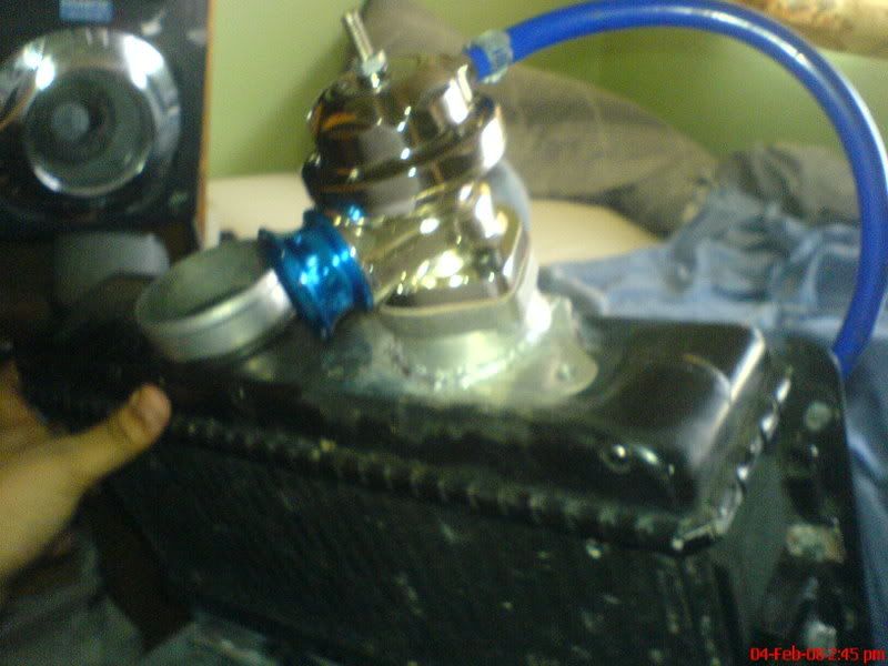

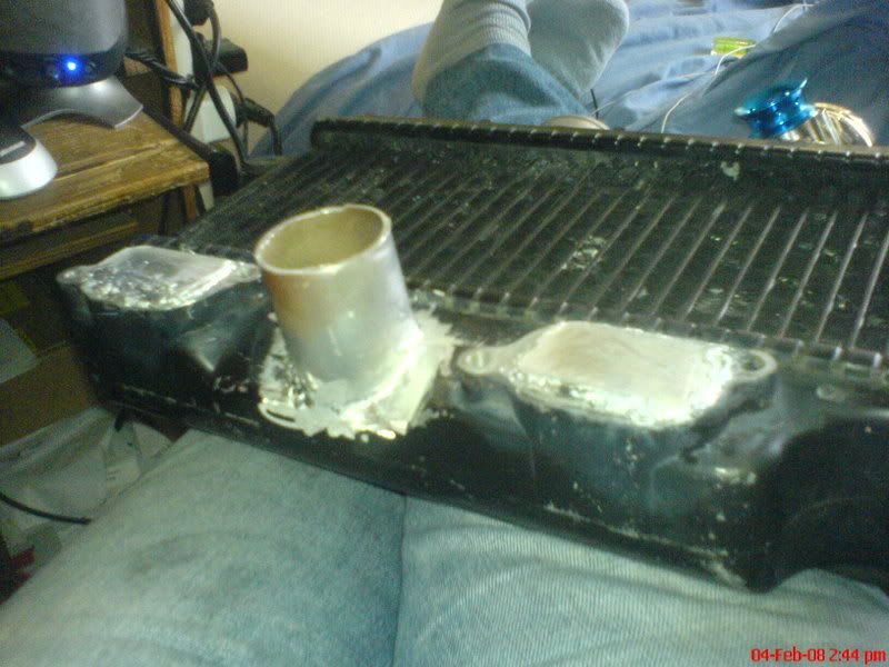

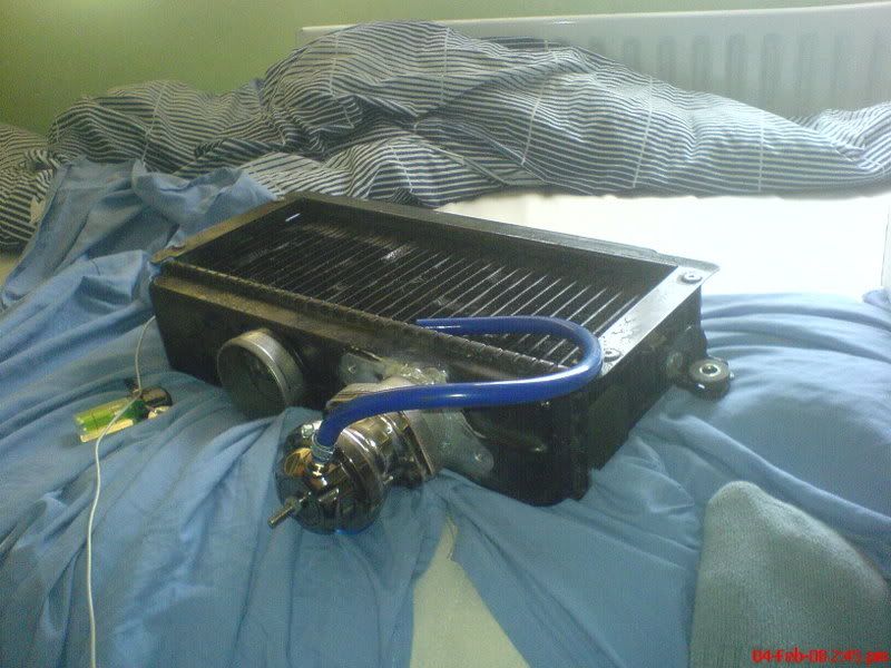

I have also been stuck on the intercooler front as i can't weld aluminium (lack of equipment) but i have found a solution for it which i will try tomorrow and i am pretty sure i will have a working intercooler tomorrow.
We got the skill just not the equipment lol. Well i heard about http://www.easyweld.com/ and thought i'd give it a shot as i heard a few good things about it.
It actaully turned out really good and is quite strong if not stronger then the base metal. Will post some pictures tomorrow. It's almost done just got to sort the short bit of piping ot go to the intercoolers inlet.

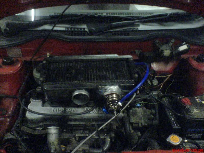

The cooler on top of the engine bay.
The bonnet closes but its very tight but i can djsut the high of the bonnet on the front. When the scoop is made it won't be a problem anyway.
The welds are good and strong as well as air tight. We grinded some bits to smooth it and the metals belnd together with the welds and you can't tell the difference. Should be completely done this weekend and bolted up ready to go for tuning. Will try and also make the scoop as well, not going with the sti 6 bonnect scoop now thought as i think its just too generic so we are going to custom make one with some metal sheets.
