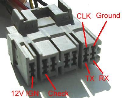

also when you tried shorting wires on connector, which did you short and which light were you looking at? as its that red led in the ecm that should flash,and if there is no faults it should flash code 55
Ah, I tried shorting the two bottom left ones, But the mechanic also had a Nissan Consult thingy, that said that there are no error codes saved.
Here is the bottom
Should i check for error codes again?
all looks to be pretty good, it is bottom left ones, if you turn the ignition on itll do a bulb test, which just turns on that little red led, then short the two wires for at least 2 seconds, after removing link, it should flash five long five short which is code 55 which means its not the crank, maf, temp, ignition or throttle circuits
Aha! according to my multimeter, the 12V Ign has 0V potential, but the pin above it has 12V?!
Gonna go try them upside down now
