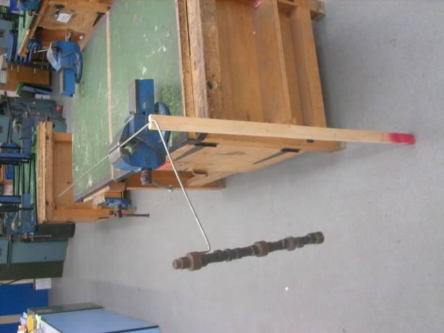

A spring is essentially a long peice of bar, (or a torsion spring) that is wound up into a coil to save space.
Put one end of a bar in a vice and grip the other with mole grips and turn. You'll notice you can wind up the bar and it springs back. Now cut some off the bar and try it again, it will be harder to twist. This is the same as what happens with a coil spring, as the spring is compressed it is twisting the bar that the spring is made from. Remove some and that bar is harder to twist, therefore its harder to compress the spring.

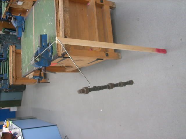

I got into work early this morning so I have done a very rough and ready experiment to illustrate. The same in principal as described above.
The load, and the length of the lever stayed constant, so it is only the ammount of bar unclamped and able to twist that changes.
Long bar - Lots of twist.
Med bar - less twist.
Short bar - less twist again.
As the bar gets shorter it gets harder to twist.

Your theory is right but unfortunately that's a load of crap, the springs aren't held in like a vice, or have I missed something here?
The bar is dropping less when shorter due to there being less leverage, the leverage on a coil spring will always be the size of one coil

Shortening the spring raises the spring rate, rasining the spring rate makes the spring more difficult to compress.
The lever in my experiment does not change length (the length from the 90degree turn to the hook the load hangs on).
If the experiment was set up with the two ends as leavers with a constant length, and a constant load applied to each end with only the length of rod between the two leavers vaired then this would then make the experiment mimic the winding action of a coil spring under load more accurately because the free coils between the mounting surface are wound from each end rather than from one end like the experiment. The same result would be obtained.
The flatened ends of the springs are the two leavers (the diameter of coil like you have stated) these are the bit of the spring that sit in the seat, the length of spring between these two is that part that winds up like the torsion spring.
Oh in that case I retract my previous statement, I guess the metal is the same springiness but the travel is shortened, I still think lowering springs are a better option though as they are designed for the job
