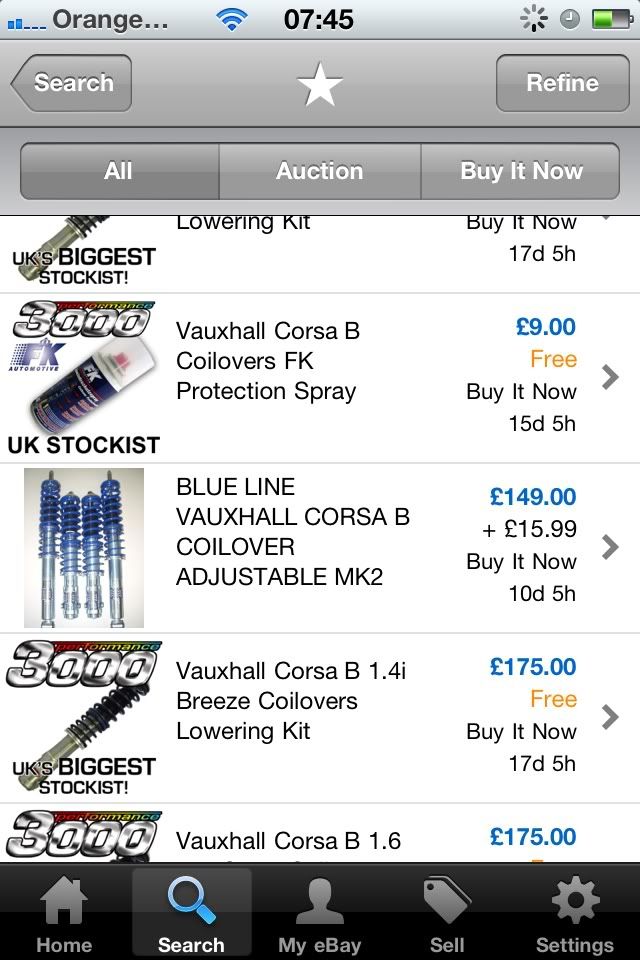

Painted on eyes?? You said you could get a proper corsa coilover kit for £150 when you can't

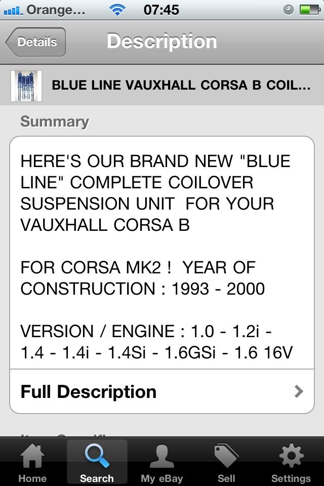

Really? Hmm ok then I must be dreaming......ohh no sorry there £149.00 my mistake. Delivery is £16 but I managed to get mine for £150 all in a few months ago. Here is some help for you as you don't seem to be able to search on eBay.
By the way i do like the saying "Have you got painted on eyes" lol made me chuckle (Y)
He must have if he can't do a 10 second search :wasntme:
Are you guys using proper adjustable rods too?
Now show me a picture of the real product not a generic one, you will find if you'd bothered to message the seller that the rears a separate strut and spring
