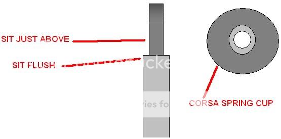

all i need to do now is weld the hose brackets on the fronts, and cut springs on the back, and i could do with some advice about how do you set the fronts up, do you have the corsa b spring cup just above the shock part were it sits fluch, then bolt it all down tight?
bnot a hard question, just need advice, the corsa b top spring cup mount, does it sit sluch with the widest part or just about for when you bolt it down, heres a pic any way to show what i mean.

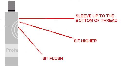

so am i better off getting a sleeve cut to the same size? so the top cup mount can sit higher?
heres my theory, a cut sleeve that sits all the way to the bottom of the top nut thread, will also able the corsa b top cup holder to sit higher up, so insted of it sitting at the "SIT FLUSH" part, it can "SIT HIGHER" is this correct?
