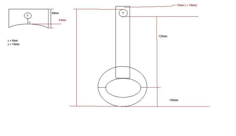

Did you guys come to any conclusions regarding using 1.0L pistons in a 1.3L to gain a higher compression ratio? I've got my scrapyard 1.3 down to the bare bones and can see that the dish (approximately 5mm) in the piston has nothing to do with valve clearance, or even the spark plug electrode. If the pistons are exactly the same (and the 1.0L rods longer) in all measurments, except for the dish, then the dish in the 1.3 piston would serve no purpose except, as someone said, to lower the compression ratio(!). So, if they are the same, using 1.0L pistons, pocketed, or notched, at the outer edges to clear the valves would be feasable and would result in bump in the compression ratio. (However, if they are the same, except for the dish, why didn't Nissan feel the need to pocket them? The dish having nothing to do with valve clearance as the valves would only contact the piston at the outer edge, not in the middle of the piston where the dish is deepest.)
The 1.3 piston is 52mm high from skirt to top. From the approximate centre of the piston pin to the piston top is 27.7mm. The rod length, from the centre of the crank throw to the centre of the piston pin is, approximately 120mm.
If someone has a 1.0L piston and rod to hand, I would really appreciate the measurements. If the 1.0L piston is do-able then I can start looking out for a 1.0L engine from my scrapyard as I'd like to make the swap.

Careless of me to overlook that. Didn't come to the top of the block, if I remember, maybe 6mm or so. Based on your drawing, however, it would seem that the pistons are not identical. Just to reiterate, I get 44.5mm, skirt to top, at the my piston's narrowest and 52mm at its widest. The bore is 71mm, same on both. Rod length, "centre to center," is 120mm on a 1.3L.
I need to get my hands on a 1.0L piston and rod assembly.
Thanks for your input.
