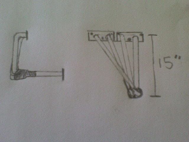

Here's a high quality sketch to show you what it's gunna look like, it's not to scale and I'm not an artist.

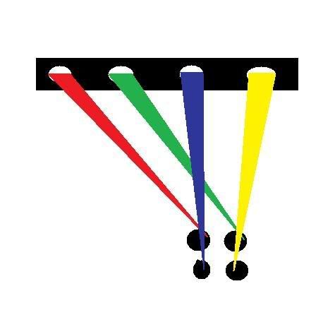

There is an easier way to get the pipes alot closer to being the same size, just have the ports furthest away from the flange connected to the closest ports.
Just in case your not sure what i mean.

Your manifold design is too long to fit in the engine bay I think, there is only 15 inches from the top to the bottom any more than that and your scraping the floor.
Well, I believe the article was written around this sort of exhaust system:-
Although surely it's possible to drop down 15" then turn to go along the bottom of the car?

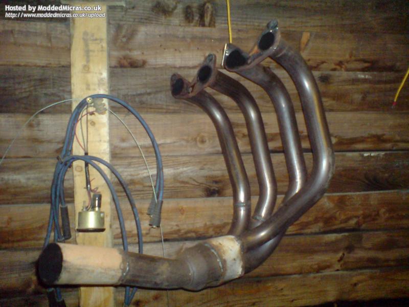

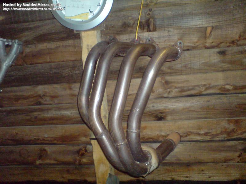

On another note, this is Mclarens 2005 F1 cars manifold:
Work of art :)

why are people putting up pictures of manifolds that have no comparison to something that you would use on a micra..
Work of art :)
Note those stepped headers ;)
