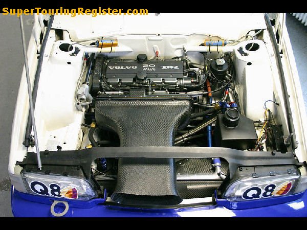

I suppose that the next step is to discuss ram airboxes a la BTCC cars :laugh:
Yes, noise considerations may well come into play, but they also seem to use 'stepped' headers which is another debateable technique to gain power...
It would be interestind to do a mega manifold rolling road compare day, but I cna't see it ever happening.
now thats a good mod.. take one of them in place of the jack! surely gonna save some wieght there!! lol thats awesome
Just an update for you guys, unfortunately something major has come up so will be unable to complete this for a couple of months if at all.
Surely that'd work better if it was more like a funnel? I.e. Large -> Small rather than Small -> Large?
I would say no, otherwise they would have done it, either that or regs determined the size of the airbox entry.
Anyway, that car was on pole half the time and often fastest through the speedtraps so I don't think that it hurt it any :D
I didn't exactly pass physics with flying colours, but I would've thought that if it started large than got smaller, the air would've been squeezed into that smaller space rather than a set amount going through a tube then being dispersed. Just my thoughts on it. :)
