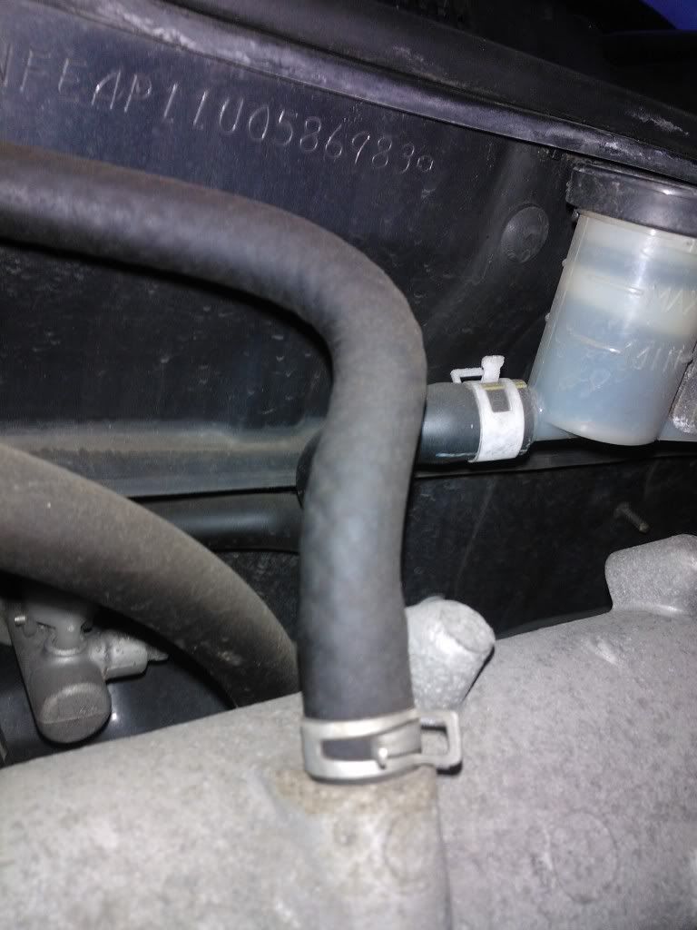

im going to take a look at my mams for the clutch with it being hydraulic cos she has the same as ill be buying for a donor

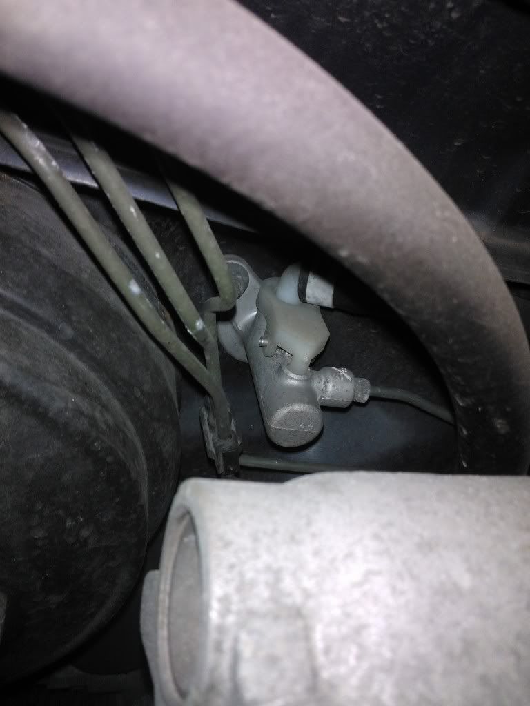

clutch master cyl setup from primera,

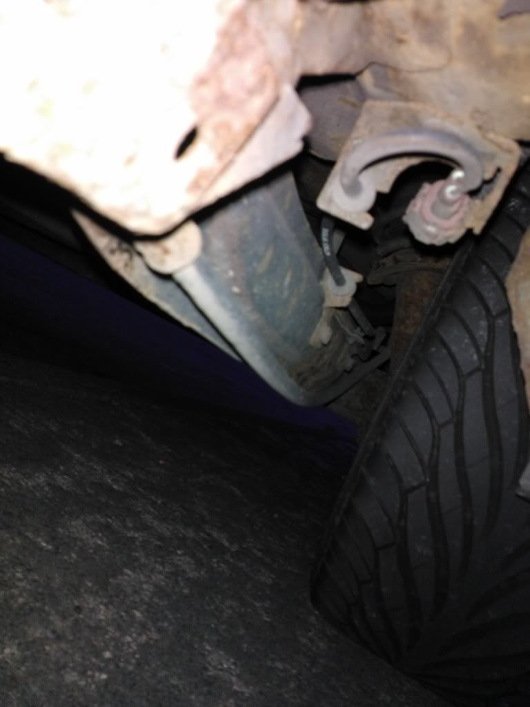

part of the rear axle fixing, cant get goood pics ill try and get it on the ramp at work soon,
but it looks like an arm like this on either side k10 style coil on shock from axle to body and what looked like a centre stabiliser/pahnard rod

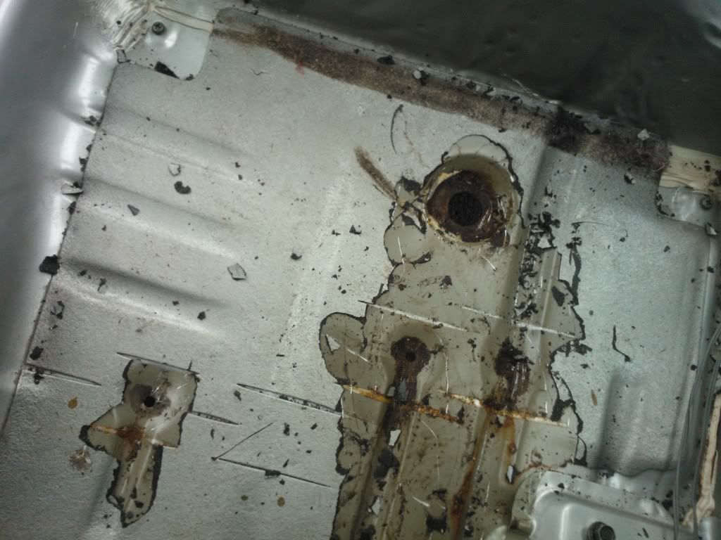

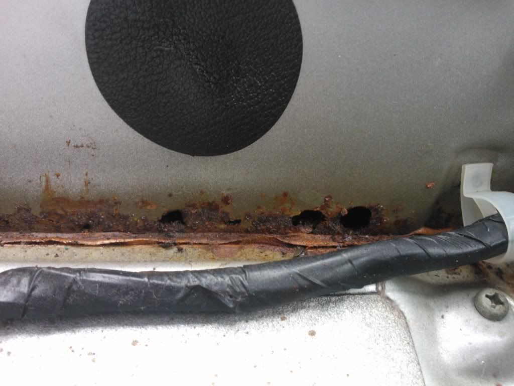

mine only one side the first pic is where the floor meeys the side down the side of the drivers seat
