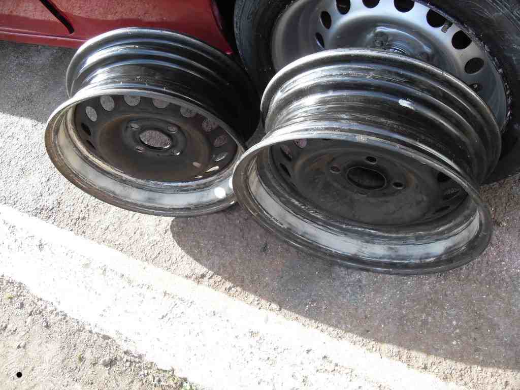

uk_facelift WROTE:
"That is alot of dish, they're going to look pretty sweet when done.
Ok ta, I'm just going to stick to chassis rails, floor and sills I think, do the rest next year.
Notice you've colour-coded the front bumper now, you colour-coding the rear and de bump stripping the sides too? And with those new rims your going to have the looks as well as the power.
thats a front (same et10) and rear (et-5 only 5mm more dish than before) in the pic matt, so little changed tbh
and the bumper insert will be blacked again, i,m still blowing in the repairs from when it was written off by the previous owner lol

SSUK WROTE:
"More poke :eek:O Woo!
Oh incidentally you were spot on with the stock wheels, 13x5.0 ET45. I must have remembered the 45 part and remembered it as 4.5. Grey hair penetrating the brain Ho-hum!
Poke wise, what do you think would be a safe number on a 13x7 on stock unmodified arches Frank? We're currently on ET37 i think......
i dont know what you would get away with tbh SSUK, my aches have been bashed upwards and folded/doubled back so they have a bit more clearance now (original arch was where the arrow is pointing to)
