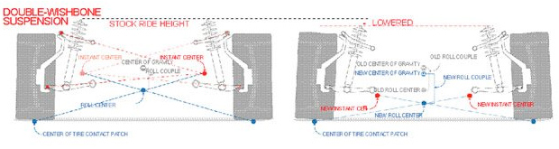

could do more to improve kasandras suspension cos I now realised her roll center was actually dropped far below her CG from lowering abit and having such high braking/power force, which may partially explain why she rolls SOO much and inherently understeers badly unless I intentionally deflate the fronts.

Ohhh getting very technical, you've increased the moment between the RC and CG so get more roll.... Try telling this to most people, 'The lower the better' is there reply :p

was just reading more into suspension & roll centres, which I found interesting to explain kasandras symptoms & how to fix but can read so much that the brain stalls lol.
most ppl may assume that lowering the whole chassis ride height will lower the CG for less weight transfer, or better aero, or just looks nice cos it tries to replicate those dedicated race car from a different environment onto a street car.
but not many ppl are aware of or even consider all the other hidden consiquences for each action, such as roll center and real-world obstruction ground clearances, which could actually work against the main assumption and end up with a worse car.
takes alot of knowledge, skill & experience for a designer/engineer/technician/team to "balance" every single aspect of the vehicle to obtain the best solution "formula" to suit that user/client/team/customer needs.

this roll center issue is one of kasandras biggest issue holding her back. was considering buying/making some lower balljoint & tie-rod joint extensions to correct the arm angles & roll centers for the new height.

Custom balljoints, etc would be nice but I wouldnt bother, it gets to the point where at the end of the day its a micra you drive daily (My opinion, feel free to make yourself an even crazier daily!!)

it could either be an £££ custom balljoint, Or tis just as simple as a lathed threaded extension. would be nice if roll center adjustment kits exist for micras but can't imagine a simple lathed bit will be too dear. need to look at afew machinists.
it's a "nice to have" mod cos imo this is the next weakest link holding back her potential but it ain't essential and just part of the development cycle.

Paul, do you remember this webpage:
http://www.motoiq.com/MagazineArtic...in-the-Geometry-Part-One-The-Roll-Center.aspx
There's a picture on the last page is a picture of modified B14 Sentra bottom arms that had been modified with "longer Chrysler parts".
Nissan likes sharing parts between models and a B14 doesn't seem that much larger than the micra, so it might use the same taper as the Sentra?
The bottom arms seem similar to the Micra's so it would seem the same mod might work... you've got a couple spare bottom arms don't you? :p

I was thinking last night about this, there's something about that setup I don't understand, if when you are working out the roll centre you join the lower ball joint and the lower arm pivot then the arms pictured seem to change neither of these?

Roll centre is the imaginary line through the centre of the wheel and inboard mount/pivot of the lower arm
You're correct in what your saying with that arm not having much difference except it's area of travel altered
I only skim read the article, I'm going off your previous post) but if somewhere in there they did lengthen (or even shorten) that arm then you'd affect Roll Centre
I understood that the relevant points were the a line going through the ball joint and the centre of the inboard suspension pivot... the other line comes at 90 degrees to the strut from the top of the strut.
It's an awful picture but shows what happens to roll centre for a lowered car with Macpherson struts
They are trying to readdress what's happened to the roll centre as the car has been lowered, if they can move the ball joint down it will help, my question is: if where the ball joint pivots remains the same relative to the hub it won't make a difference how long the ball joint or how far down the arm because the instant centre is a line joining the pivot points not a line along the suspension arm.
I don't know if they lengthened the bottom arm but I imagine it would effect camber more than anything? but yes would effect roll centre too...
My brain is saying that where the ball joint pivot needs spacing down rather than the lower arm being moved down (but the pivot remaining at the same spot) which seems to be what the longer ball joints would do, maybe you'd have to have them in your hands to really see what's going on...
You're quite right. I almost quoted my own posts and corrected it then realising it was me that said. Things we say in a rush eh. I'm not even sure how a line through tyre centre and inboard mount would even help
That's a much clearer photo of roll centre (if it works)
Now I'm back on track,
Their idea checks out for raising roll centre as the point of intersection is sooner for the drawing
When you consider the equation involving roll centre the length of the arm comes into play. It'll affect camber curve for sure, but it'll also affect the moment radius in the equation. It'll also affect scrub radius. Lower moment radius = higher roll centre
Food for thought
Considering that manufacturers aims for low front roll centre and high rear, and you see the length of the moment arms involved vs front to rear its a real world example if you was to notice it
