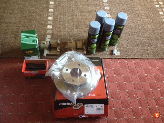

Parts started arriving :) Wheel bearings, calipers, discs, pads and stone chip grey paint for inside the arches.

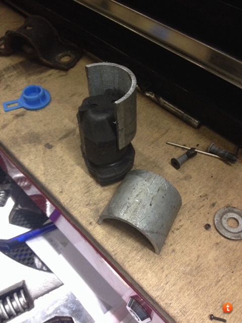

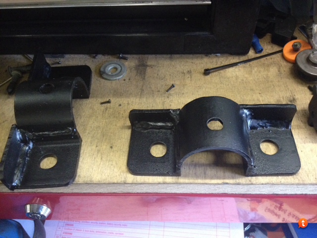

I found my poly bush kit And k11 wish bones. The rear rubber mount is bigger than k10 so I made my own brackets.

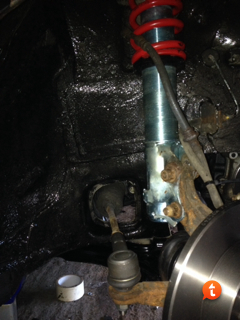

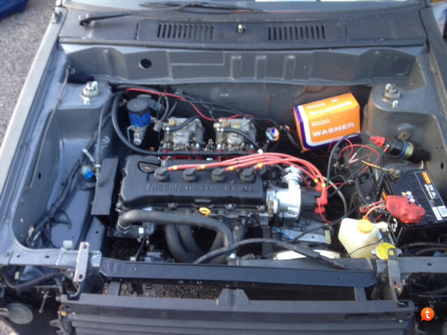

Sorted gear linkage and painted in the arches today. Going to run a single belt for water pump and alternator. Getting wheels sorted saturday so i can put in back on the floor. Ill sort the rad mounts out tomorrow and mock up front engine staberliser mount. progress feels good :)
Upper radiator mounts are different to a K10. They fit into grommets under the slam panel where ours bolt into it.
Size n pipe wise they're the same. Few brackets won't be hard to knock up
