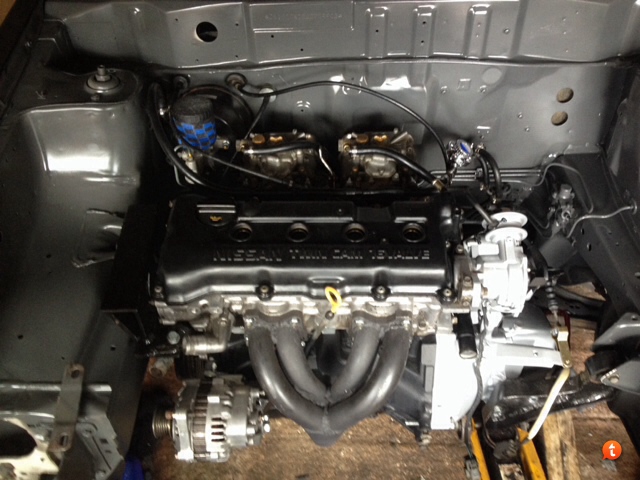

Just finished painting the engine:
And engine bay prep is underway
This is not easy as I don't have and lifting equipment and no one was free to help free the engine from the bay! Getting there
So at 3:20 in the morning after prepping and spraying till 10 at night I was on the way home from a friends house and could not hold back the anticipation of how my bay looked. So I went and looked. Result :
Mega happy!!! Tomorrow to continue...
4-1 seemed to be the easiest to make as I had to make it away from the car. Need to mock up down pipe and flexi and weld it up.
Anywhere between the pump and the engine, as its an in-tank pump that means anywhere between the tank and the engine :)
It was a mechanical pump on engine I blocked off and going to use I think it's a silver top carb fuel pump near tank. Thanks guys. Make the bay a bit less cluttered. Carbs are on and vac lines and fuels line done in the bay now. Drive shafts, wiring, fuel pump and lines for it to do next
