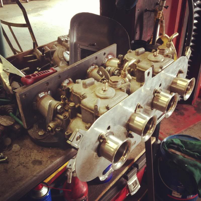

made up inlet mani:

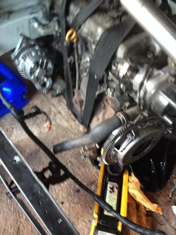

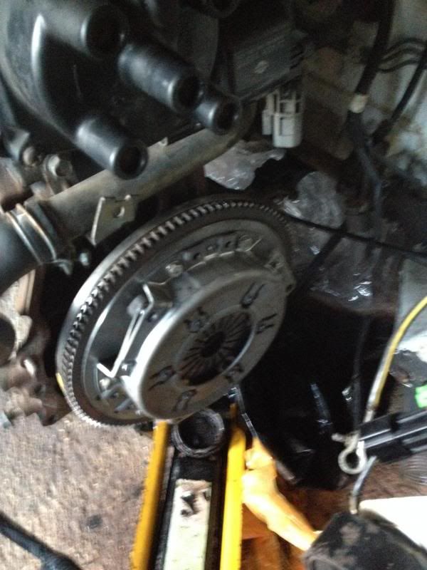

Installed the Bored out k11 1.ol flywheel and k 10 clutch :

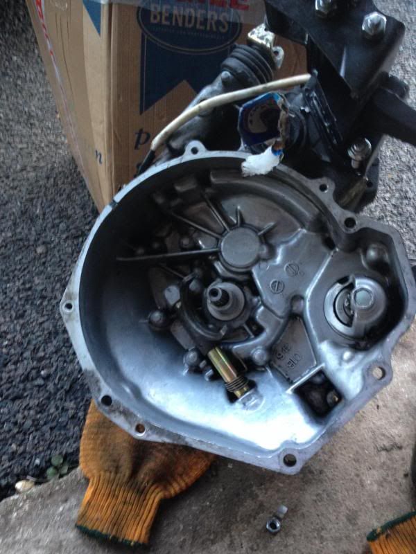

Cleaned out the k10 gearbox bell housing (help form Mphgoose):

I'm using franks hybrid clutch.
Cg13 friction plate (45 degree ground onto outside edge) bolted to cg10 spline bit. Then grind down inside edge of the cover bit.
Just about handled the power, little bit off slip, but I never put the valve spring on the lever like he suggested. Will be doing that once mine is running again :)

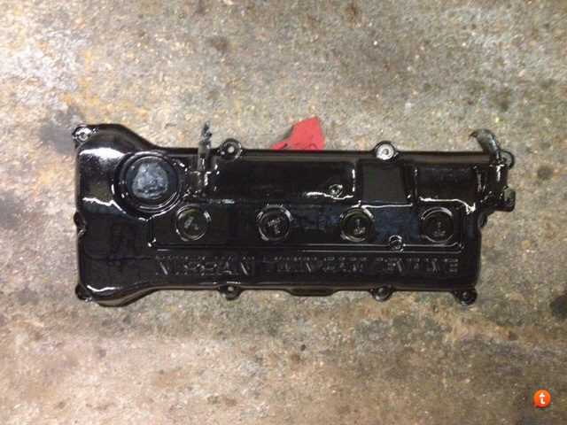

Well I painted my can cover today:

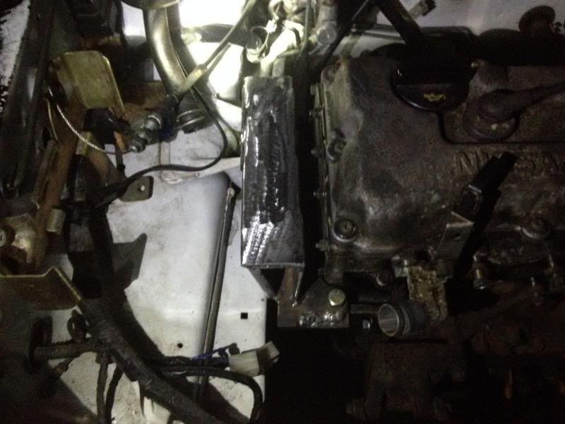

Then went to the garage to clean up the block ready for paint and ended up mostly stripping the bay:
Edit: better picture
Hope to clean it up more tomorrow. Get the wings off and start prep for paint.
