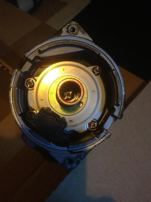

Thinking about it the dizzy has no points but has what looks like a trigger wheel behind the rotor arm. So I think I need a different dizzy.
i dont have an ecu but i guess it did. ill have to work something out. need a different or modified dizzy from another engine.
Leaves you in the same place as me then at the mo :( the ds is a pain to get parts for. I'm going to get a de dizzy and rewire ot to work with a cheap engine management
the o rings are the same and the bit that interacts with the camshaft is the same with the same offet. looks like a winner. ill see if its fits in the head tomorrow. The one i have has a lead with 4 wires coming out of it. I take i wont need these wires as they are for the ecc?
it fits! so the 4 wires coming out of it are redundant? do i just need the king lead, wire up the coil and the vac lines?
best to check the fsm wiring diags tbh, there is usually a 12v+ feed wire, and earth, and a signal wire to trigger the coil :)
I think I have worked it out. I spun the dizzy up and one wire output 0.4v ish but fluctuated so guessing signal wire. One wire is earth and one is gold played which I assume by elimination is the positive.
