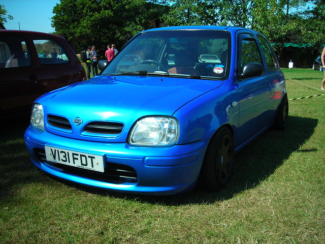

I was running 13x7 -7 with 165/55, rear was ok with bit of DIY arch roll, Front needed quite a bit of negative camber.
My old car with the setup above
13x7 et6 is pretty much perfect. 165/65 tyres for some stretch and they'll fit fine.
These are 13x7 et5

mckenziecz, i actually have a pic of your car with them wheels on in a screen saver i made up, along with euro_micras, martinbs, and franks side on pic on his steels, along with others ive found searching on here hehe. ive watched quite a few sets of minilite type wheels with the -7 offset, but let them go. the set im currently wanting are alleycat rally specials :D also talking to some people about ats clasics, 7x13 but a much friendlier ET of +20, and a set of smoor roadsters :D hmmm much to consider :D i have an arch roller, didnt know if the steel was up to a bit of stretching as it seems very thin compared to what im used to (vw)
Et 6 is very good, but as McZ has proved -7 can be coped with. The ally cats sound cool.
Any oppertunity to whore some old pics of mine :suspect:
7x13 Et6
