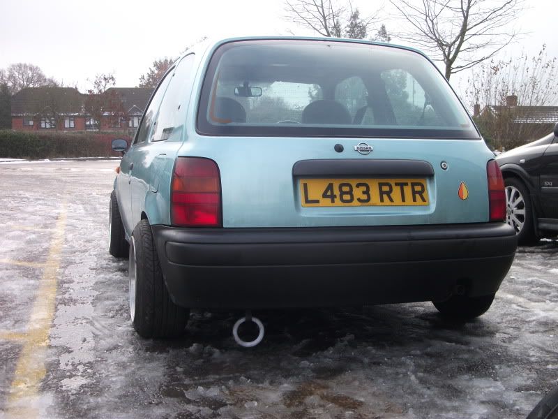

Thats -13 8"s on the wide side of a car lowered with stock panhard rod. Tyres are 165/55's
I'm sure you must have already but check out tyrestretch.com to see how various tyres look on different widths.
-13, but as I say they were on the side were the lowering had moved the wheel away from the arch, so in effect probably making them appears something aaround 0.

i tried these et0,s on the front of mine and it was barely drivable :eek:

Trouble is i cant really 'borrow' a set of wheels and tyres to trial fit. Only thing i can do is space it. I might give up on the idea as its something that needs to be right. By the time i buy new wheels and tyres,cut the arches etc it could work out to not working at all and as you said Frank,could make the car barely drivable :(
