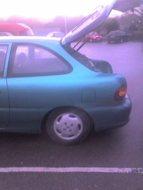

first of all i changed all the pannels :) thats the doors, bonnet, grill, wings, petrol cap and rear hatch.
i don't have a pic but it looks pretty much the same ;)

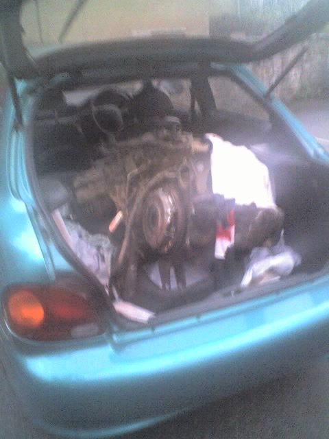

then i got a spare engine and gearbox for £75 :D

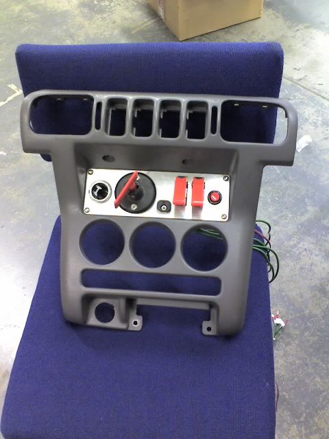

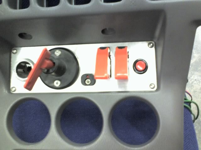

then i sorted out the starting controls (at the moment i have to hot wire it)

hold on new engine? wheres the old 1.6 gone?
it's still in the car, i just have a spare engine because the one in there isn't running well and i'm not exactly sure what the problem is so i might just rebuit the whole thing and use the best bits from each engine.
i origanaly just wanted the GA16 gearbox for my 1.3 and the guy in the scrappy said he'd have to take the engine out so i asked him how much it would be for both and he said £75 which includes the TB and a pre nats ECU so i got the lot :D

the start button was simple, i'll see if i can sort a guide out with some pics for your site goldstar ;)
basically you tap into two wires in the ignition loom and put a switch across them :) simple as that. there is a relay further down the line already in the micra wiring so you don't need anything other than a switch.

i'll try and sort out a guide tonight when i install the ignition pannel :D

damn.......... u cant see it!!!! he does the 2 switch and then the button!!! witch start the engine!!!!!!!
