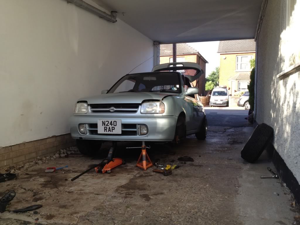

arch to floor measurement of 555mm with a 155/70/13

WDIDT ?
thought i better get my finger out and fit that 1367 for donny/japfest
