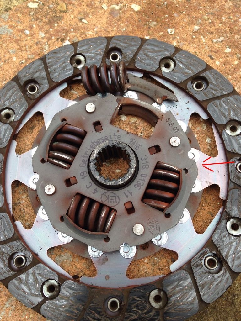

Sounds like an internal problem, probably a spring gone, a few on here have had that. Unlucky mate.
10/10 mate.
Yep the spring housing had cracked and released on me of the springs which jammed behind the pressure plate springs.
You can also see arrowed where the housing is starting to crack on one of the other areas
I'm a bit bummed over this as I went for a LUK clutch kit as I thought they were good quality. As you can see the clutch has hardly any wear and has less than 4K miles on it.
Quick question: If I were to buy just a new clutch plate from a different manufacturers, would I work with my existing pressure plate?

10/10 mate.
What power are you running to do that, or has the clutch been abused?
It's all stock Matt, except for a Frank Mani.
The clutch has been well cared for. Im a 44 year old git with a lot of mechanical sympathy. I never hammer my cars as I like them to last.
I have an LUK clutch kit in mine, And I don't have the lightest of right foots, I've done about 8K on mine so far and its fine, It could have just been a faulty one, My dad used to be a taxi driver and when he had clutches done he always had LUK clutches
I can't comment on LUK kits because I have never used one, but I hammer my car everywhere (It gets used on the morning commute and lots, and lots of highway onramps), Nissan OEM in mine is the only way to go, 10k miles now, no issues (Not that there should have been)
