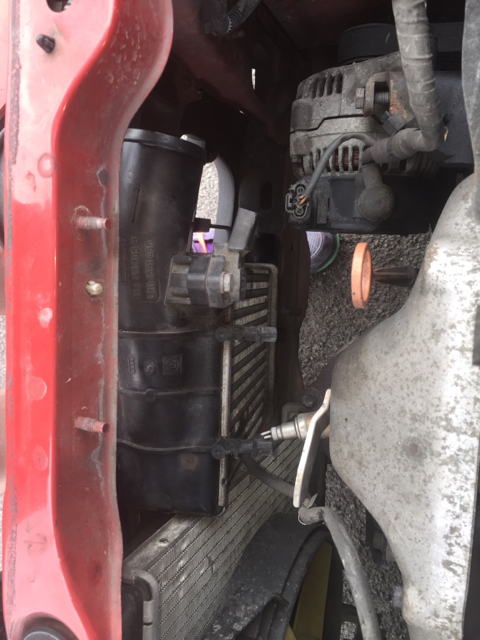

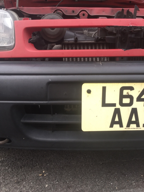

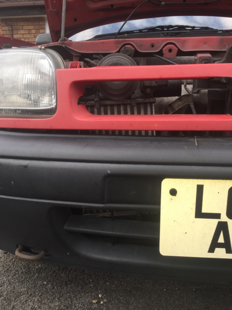

Done a few mock ups of my intercooler

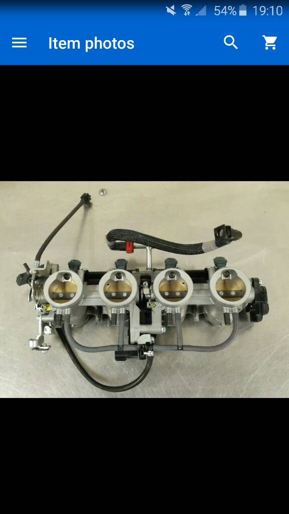

Theres a few options. Quite an interesting one on ebay for 180 with loom and software.
But im open to suggestions.
