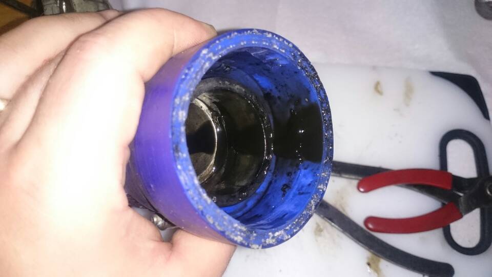

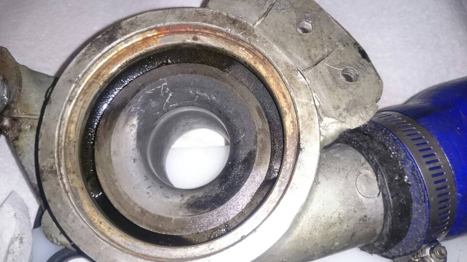

The engine starts up fine, runs ok and isn't spitting any oil with the turbo disconnected.... Plus. The oil in in the inlet of the turbo... How'd it get there from the Ringlands going?

The intercooler pipe blew off and the huge release in pressure sucked oil out through the compressor seal and wrongied the turdo.
But it was on its way out anyway due to the excessive play in the shaft, general condition of the oil and Wear.
The shaft is worn to a lip where the bushings go....
The squealing under boost kinda points to the turbo too...
there,s no "seal" as such on the turbo tho ant, just snug fitting bearings (and a springy collar/ring on the turbine end)

Nah, you can see where mine had worn away the blades on the compressor wheel look, your ringlands have let go dude !
Any oil on the piston crowns when you look down the plugholes ?
