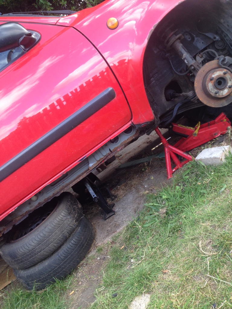

jacked up and tyres under for support, doing the inner cut out and having new inner done and then spot weld the outer in place

my rear spring trumpet had a hole in so easy fix got 1.2mm mild cut it in place and mig welded it solid now

@Andy5077 more to come but it was like p***ing in a fish tank, if u got a mig and all the inner sills and outer, with 1.2mm Mild plates it's very simple took me 2 hours and not rust free, thanks to one and only man who has told me on how to do it and what not @frank
Has short cuts and has gave me many advice and don't take 3 steps back take 1 step forward.
took carpets off
Then this
this was only so carpet don't burn with the sills getting hot. Also am not using it anymore and no more back seat
marking where I wanted the inner lines so the outer fits on the line, then just tack welded it
here was the tack
did this by end to end inner only on few tacks then ended up with a stronger welds and next I came across a patch I had rusted so u cut out some sheets and welded it
mig was the best welded I had ever used not even one burn through out and it was coming out very good, gasless, 0.8 mm. Now u can see where I made the patch
it was all looking new now and the rust middle section got cut off which u don't need,
filled up the holes and good as new,
you can see from the rear I have waxed oil all in the inner so no more rust,
cleaned the paint where I needed and welded on need to smooth it down,
and that's all done, the outer sill been drilled on bottom for spot welds more pictures to come Tommow, and more wax oil on the rear
good bye rust

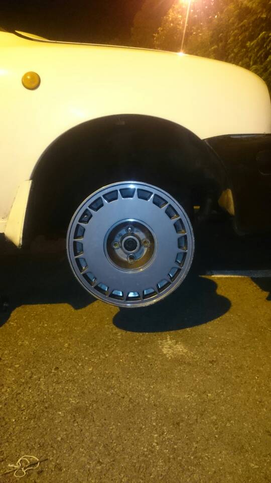

Here's BAM A LAM with her new black alloys on, or off my old girl I should say. Bit of work to make them look good yet.
Just messing at this time.
Here's my old girl, how much do you think she was lowered by?
