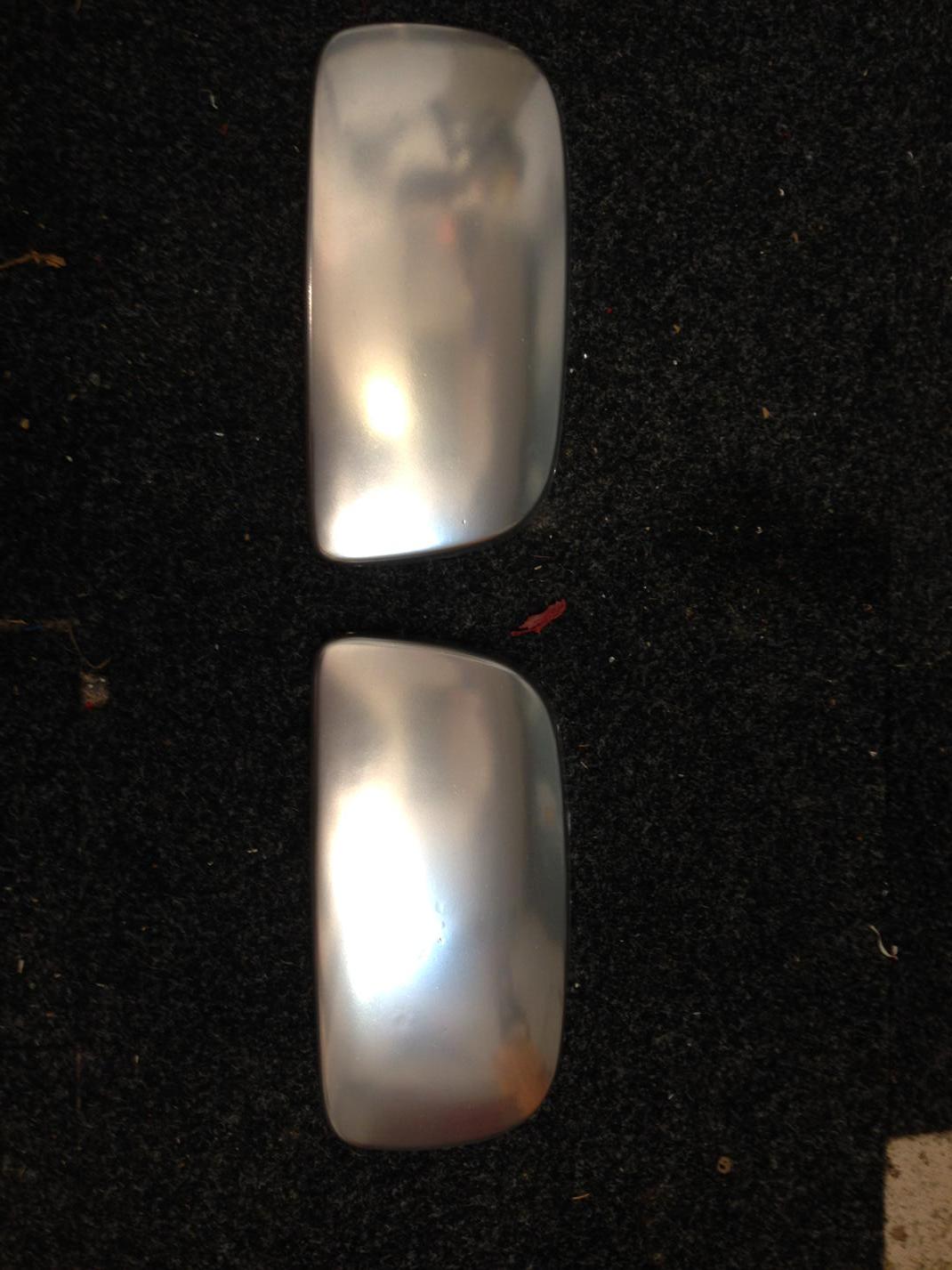

Painted these...
CFZYw6mWgAAR5zk.jpg:large
Though just not sure I should have done a layer of lacquer, seems to hve reacted with the paint... So I may have to do it all again...
