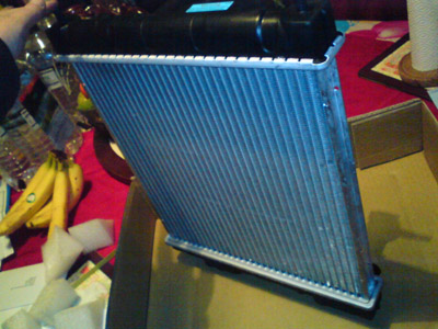

I was looking at sr20 rads.. Seems a good upgrade.Started working on the fittings for a new full width radiator upgrade.
This for turbo or na build. I suppose yeah, starlets are double core as standard no? No they not if I remember correctly. Guessing aftermarket rad?Opted for a starlet rad, as it offered the most flexibility for me with respect to size, current placement of kit + scope for future changes.
The other major is the hose placements are very close to the OEM K11 radiator layout.

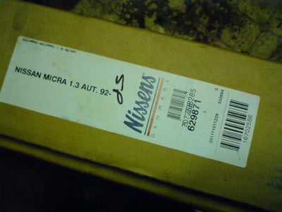

I'm using a thick standard automatic k11 rad made by Nissen model 629871, it's 26mm thick and handles my 160bhp 10psi on a hot trackday all day no probs

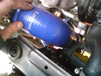

I have a fully alloy version but it's far too thick and would foul on the turbo manifold. The current one is too close already at ~5mm clearance plus having to cut out part of the fan cowling in order to fit it.
Jesus... That's tight. What oil temps do you hit with some good turbo use... I hit around 90-110c I don't know if that would even warrant an oil cooler. Would cooler oil risk lack of lubrication? Would you consider moving rad further to the front? Cutting in slightly to the bumper?
