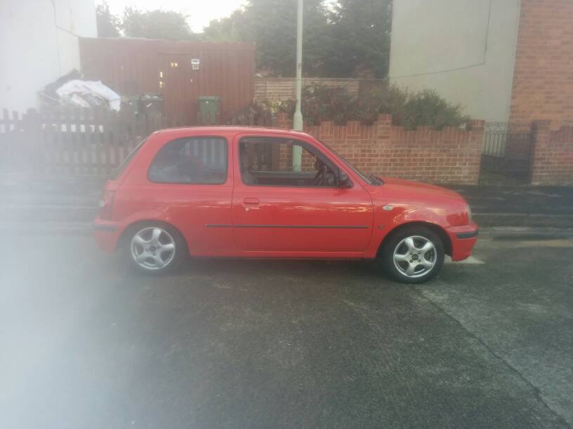

The "40mm" springs I got for the back were actually cut down further so it's way lower at the back, and I'm on standard shocks so I need to fix it quick.
