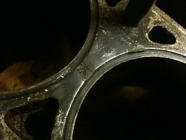

5 deg of retard added to ed,s map mate, and about 11:1 on paper, and yes the weldfilled/skimmed head and k12 fire rings added :)
Good to know, will have to write that down :) shamelessly plagiarising your work for my build if ya dont mind. Taken alot of inspiration from yourself and solarice :). Are the k12 rings strictly necessary? Also they a straight fit?

np mate :) and you have to cut the fire rings out, they have embossed rings that compress where needed, and they help to avoid the head gasket fire rings from expanding under pressure like this (see the bunched up fibre surround that has deformed as the ring shifted outwards)

So you cut them out of the k12 but how are they fitted to the cg? Above, below or instead of k11 fire rings?
yes the k12 gasket is a 2 skin multi layer steel jobbie (mls) so you cut the top or bottom skin and leave those stumps that are hanging down (for location around the cylinders/jackets)
then fit the stock gasket ontop, they are 20 thou uncompressed, and 10 thou when compressed (so very thin) :)
