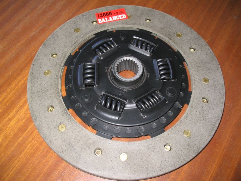

So you will mate this to a 1.0 gearbox? Will the clutch take the torque?
i think thats gonna depend on how much boost i run tbh airmike, this hybrid clutch is nowhere near slipping atm, and i guess it,ll handle a torque gain of around +25% (and the plate is very old)
so i,ll have to suck it and see
Im thinking of having a clutch plate made when i change to a 1.0 gbox. It's a carbon plate and costs around 100€ to make. I know of someone with a nissan s14 running 380hp with a stock clutch and their carbon plate. Should be good for around 130hp on the 1.0 plate imho...
