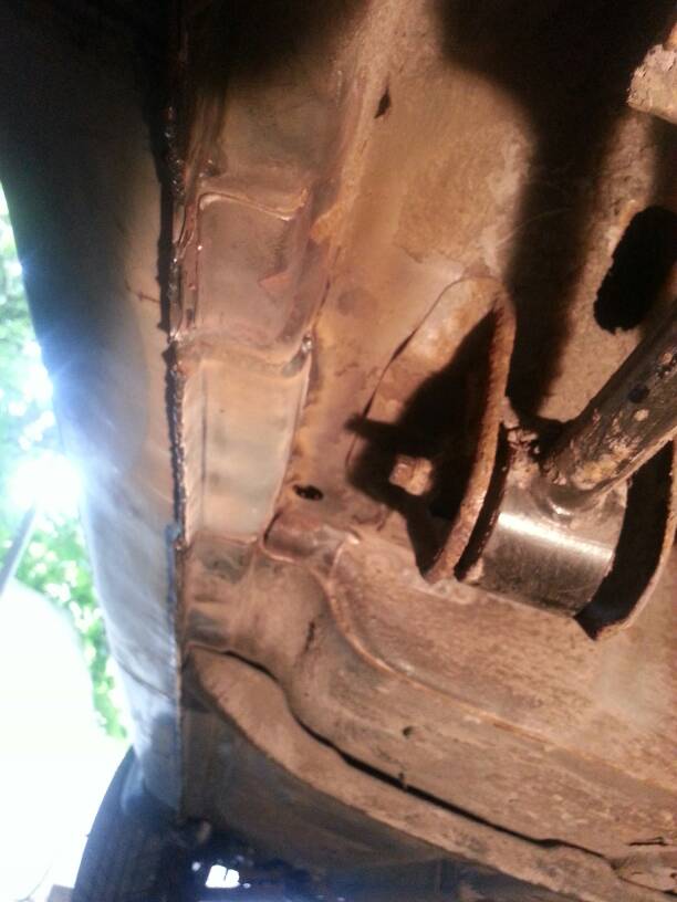

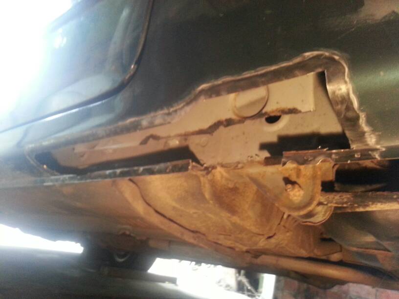

Started my welding marathon:

Ed that's bloody brilliant welding for such thin metal!
Ta mate! I think it's all about the fit-up. Make the new bit of metal fit right then weld it, gaps more than 1mm mean you blow a hole too easy. Then do lots of half second 'dot' welds which slightly overlap (on higher amps than you would expect).
tiz, i,ve never seen a sill TIG welded before :)
Nah, it's mig:) got another cheap one on Ebay. 90amp max but does car stuff fine:) I did TIG a sill a couple of years ago, they are too cruddy and you end up messing up the electrode every 2 seconds. Plus upside down TIG is hard work!!
Pretty much how we did ours except we got the joggling tool out and made the outer plate sit flush, making for an invisible repair, (we also spot welded the lower sill sections together). Not seen anone bother to replace the inner sill element though, just cut it back and slap on an outer plate.
