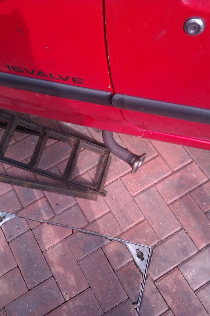

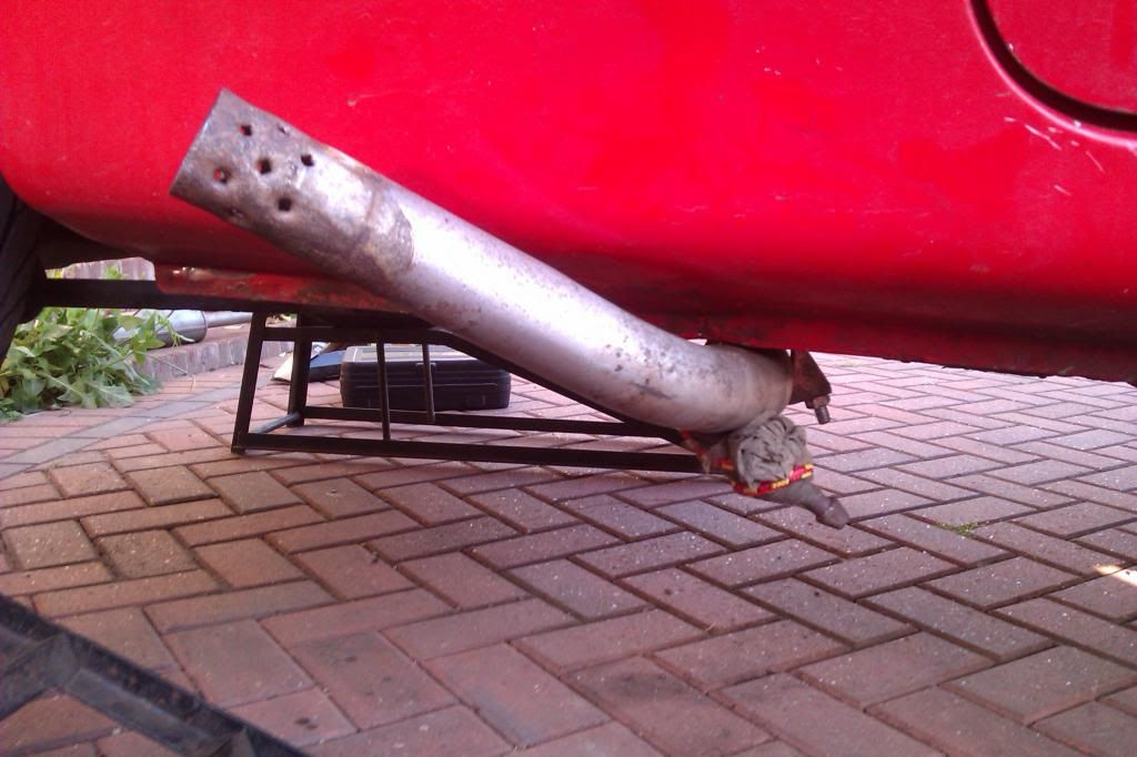

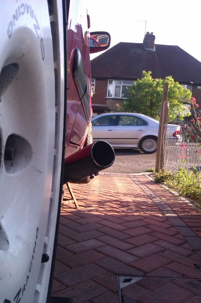

Wdidy? Yesterday, made a side exit for fun :) it started like this :
made out of an old downpipe, i did a video but the sound is crap for some reason, mike was playing up i think... Anyway it developed a bit from that point and became more like this :

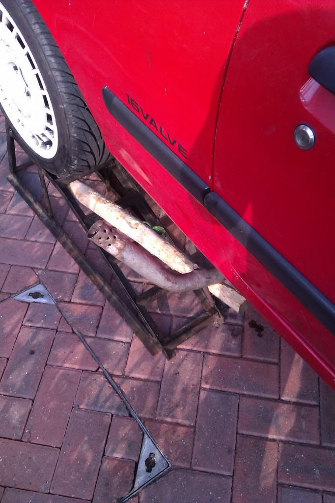

Propped up at that point as i hadnt secured it/finished the piping fully. Did a video of the noise though (excuse the commentary lol sound like an arse). Edit: This bit is a video if you click on it lol just looks like a photo for some reason, no play icon:

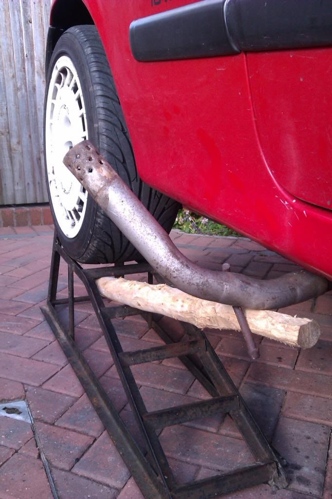

After that i got it tucked away a bit better and had a play with a tip for the lulz :p
Todays mission: find a silencer to replace the middle cat with and therefore gain flow and lose annoying tractorish rasp and bean can effect :p If i can get this to sound nice and flow well (currently made from the old stock pipes and some extra bits) i may do a bigger bore version and forego the peter lloyd system for a while :) this is funnier

That side exhaust looks like the flamethrowers they use in South Africa under their cars. If they're getting hassle at a junction or lights...believe it or not...they can torch their assailants (legal) Unbelievable or what !!!!!
