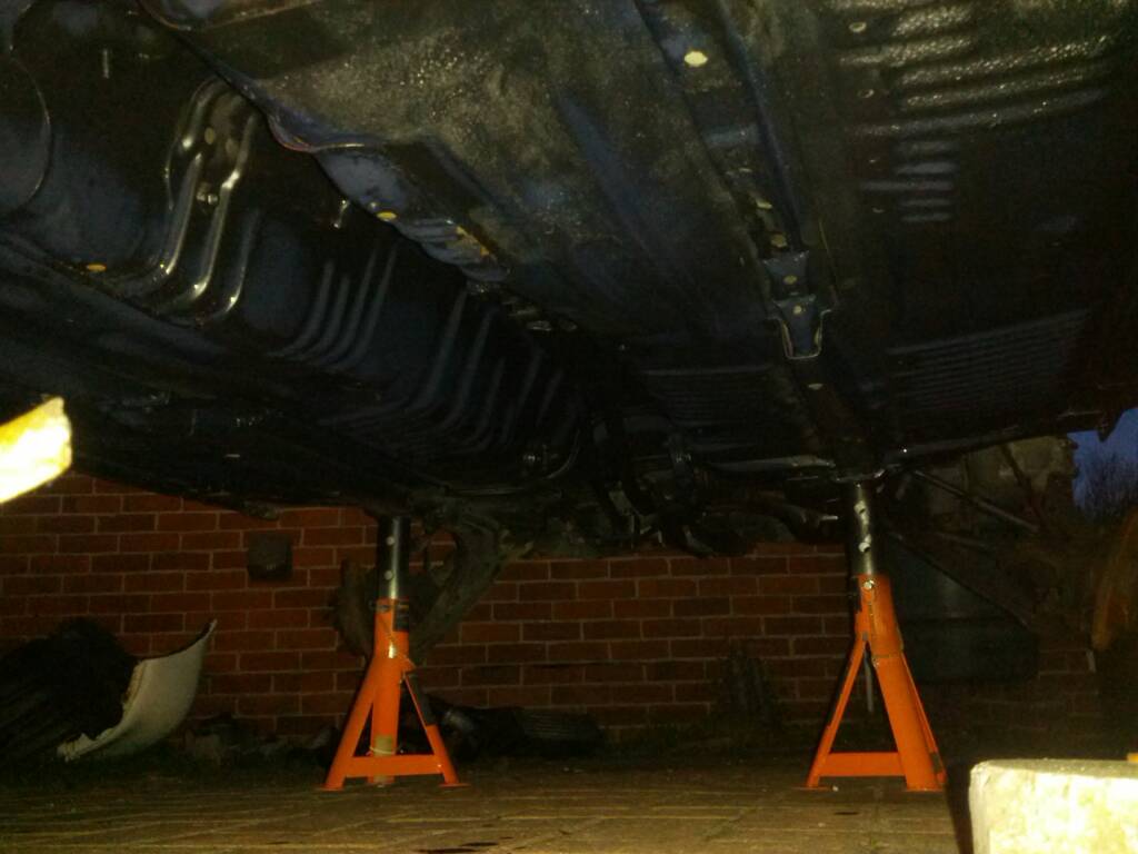

She went in for an oil and filter change + gearbox oil change today. First time I've been under her (no puns please) she's spotless underneath, not a spot of the brown stuff anywhere - amazing !!!
Spotted my tracking out though, gonna have that done. Missus's micra goes in tomorrow for the same treatment. I've already been under this one - steady boys - steady.

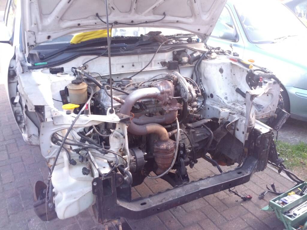

Put the x-member, radiator and lock support panel one. Here is the video.
This still to do:
1. Mend the broken part of driver side headlight.
2. run through a Tap to correct the cross threaded captive nut underneath the car.
3. Fix the screen wash pump. the rear one is not working
4. Put the headlights and bumper on.
5. New brake fluid and bleeding the brakes.
6. Put the tires on
7. Welding
8. MOT
9. VOSA
10. insurance and on the road.
Thanks to frank for all his advice and instructions and thanks to my neighbor who give me support and let me use his equipments.

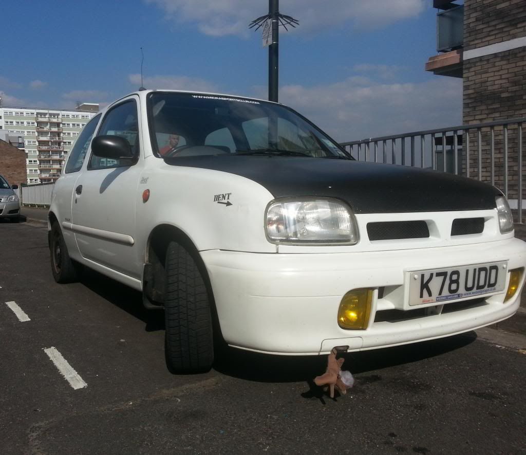

Heres the picture of the car with new front grill. makes me think maybe I should smooth the whole front of the car, bumper and all...

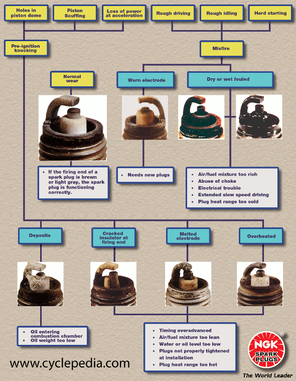

They look as if its running a little lean JK no much colour to them
yea there are two wet spark plugs as oily. (the last two)... lean? is there any problem on my car?
mine could be normal wear or worn electrode...
Theres no electrode wear on yours JK, they just look very "clean" the top two plugs. You would be looking for a chocolatey/biscuit colour on them ideally.
Could be two faulty injectors causing a lean mixture, that's why your engine cuts out maybe?

oil on plug thread not on electrodes :) looks ok me think

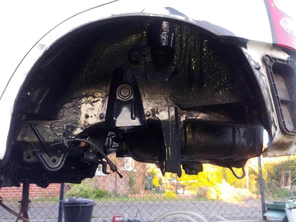

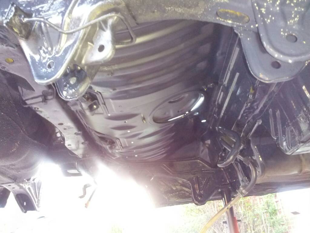

Bought some underseal to protect the front end and to spray in to the rear quarters by pulling the lining back. Has anyone used this?
