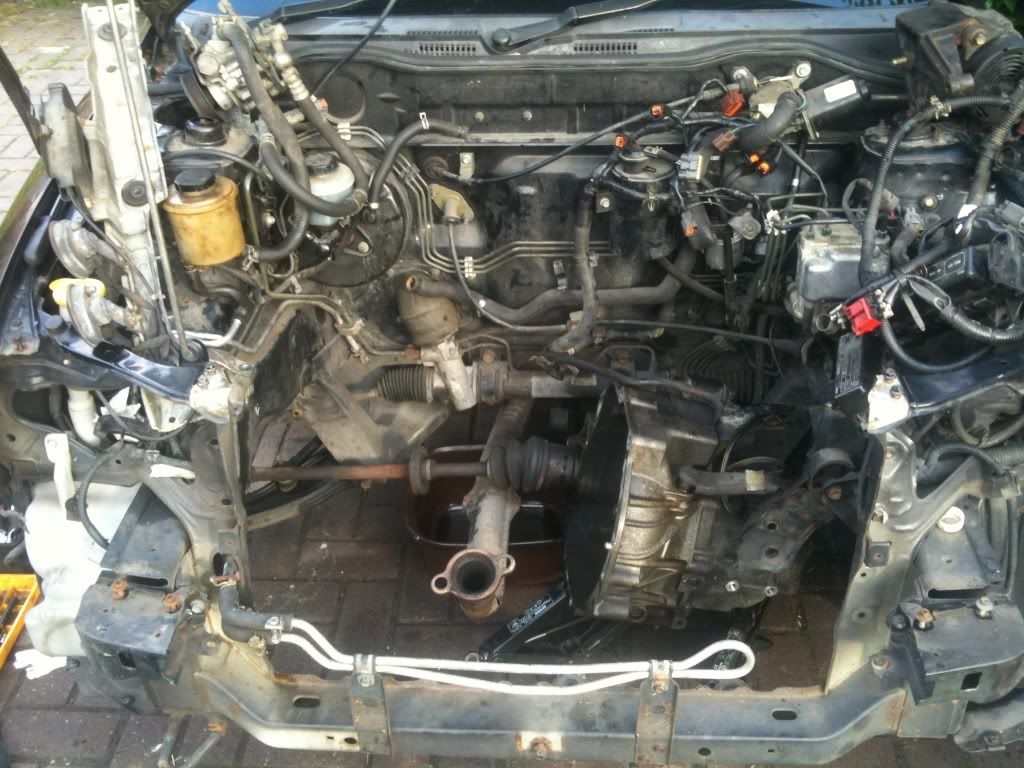

Okay, ive arranged for a crane. Im going to pick it up today and i have it till sunday the latest.
Only thing is the crane doesnt have anything to tie to the engine. He said he uses seatbelts :S.
smashin. you could support the block on crane, split the box and lift the block out before sunday where i'll help ya swap the bits then lower the engine back in
you have any tow rope with loop ends? or anything strong really
Ok good knows. I have the block out. removed the flywheel, filter, clutch and sump. Everything off it but the pulley which i dnt have a big enough socket for. I used seatbelts on the crane to lift the block out leaving the gearbox in place.
Only thing left is removing the pulley, then sticking the rest back.
