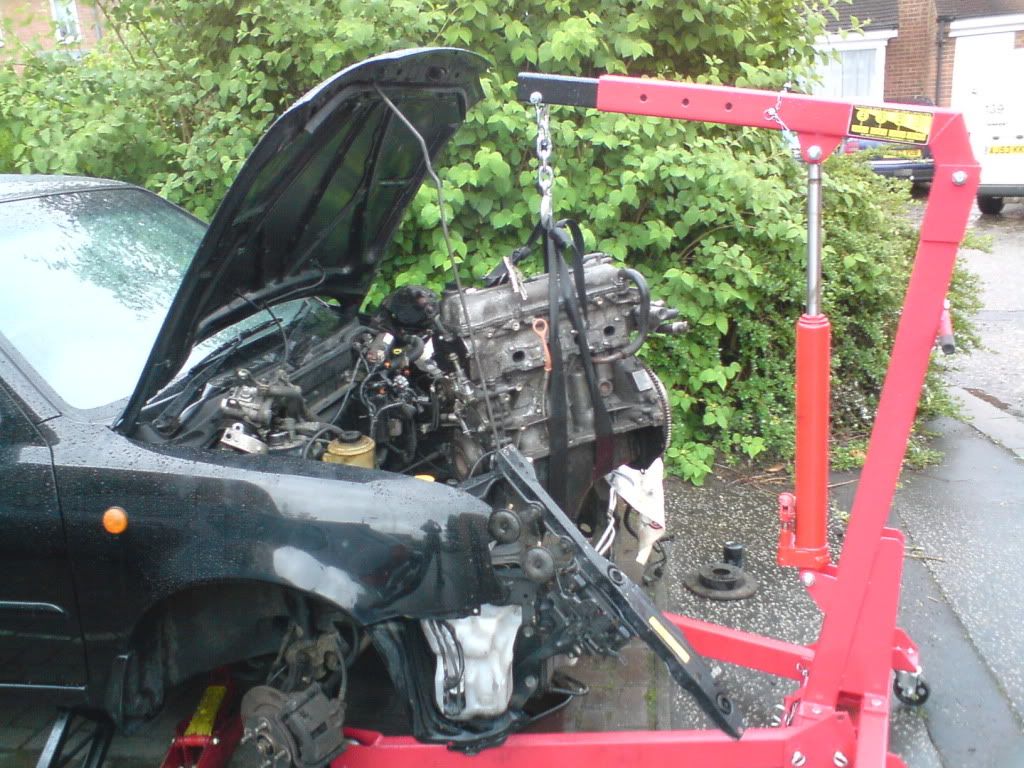

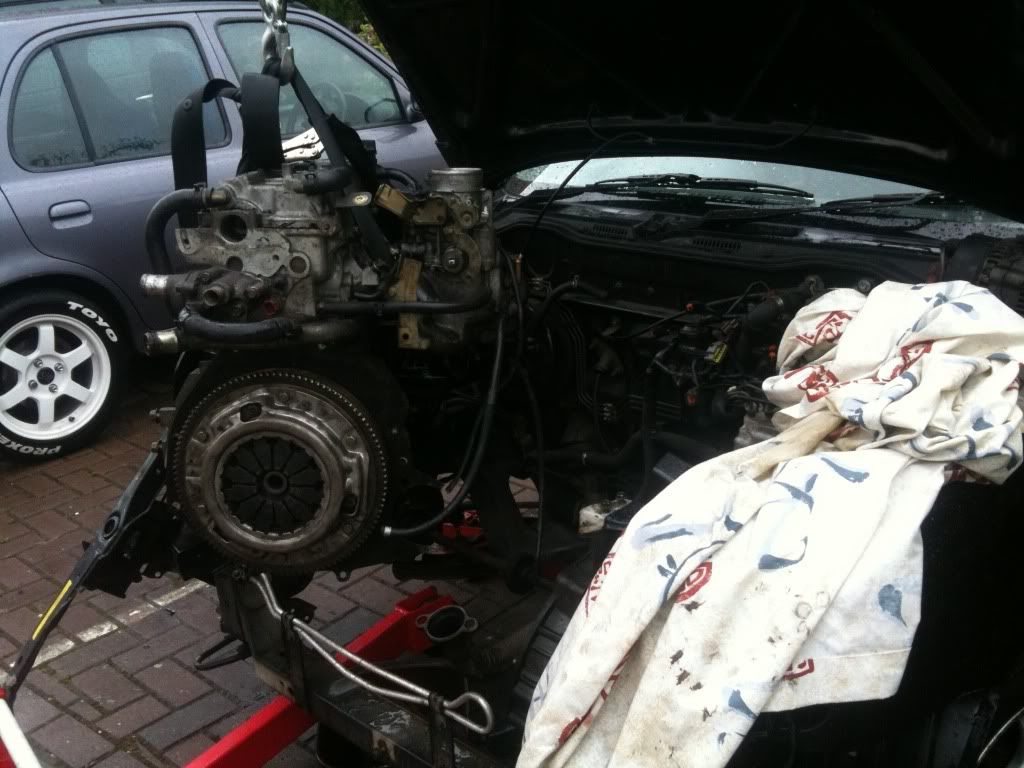

arrived at sulurs with bare engine in morning. his engine was out too making the process easier.
fitted pickup & sump and other bits from his engine. heavy rain didn't help

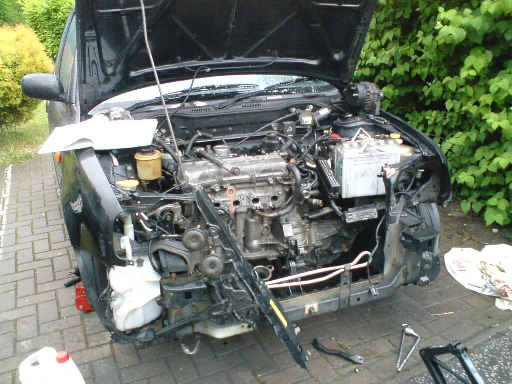

lowered engine in

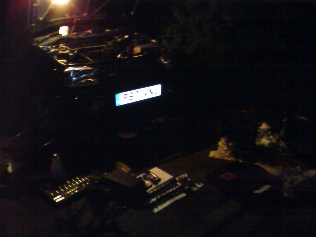

mounted, only hook up battery & oil pressure sensor to check there's oil pressure. crank for few secs oil light goes out, job done. had to jet off at 5pm for me m8s bday and let sulur & brother finish off the reassembly
7.30 had a txt from sulur the engine was assembled, started but smoked alot. damn. arranged to get new head gasket in morning cos i remember it's been reused and googled that they shouldn't.

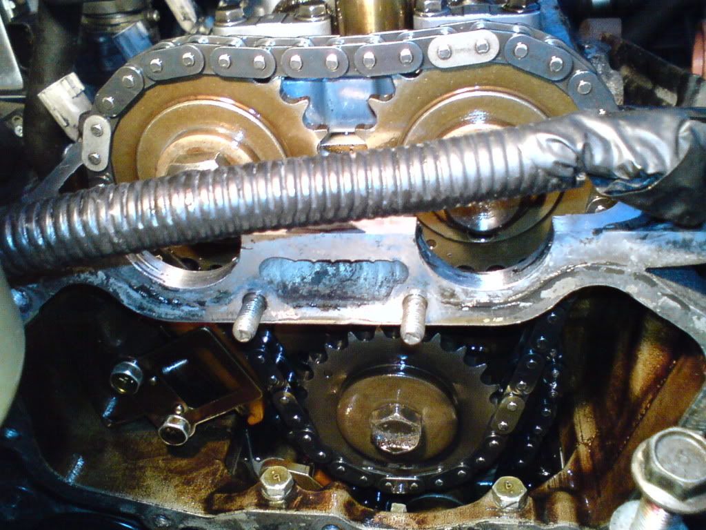

photo the chain before removing cams

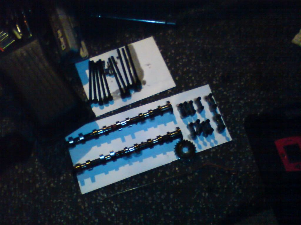

cams off

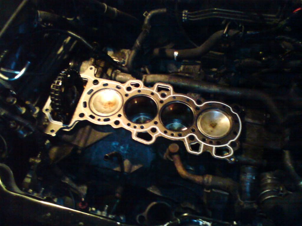

head off
gave both block & head surface a good degrease & dry with brake cleaner & tissue
fit new gasket. its graphite type gasket which i never used before.

all setup, started engine nervously, it runs. datascan reads all normal at first, fires smoothly. but then as it warms up to starts to idle roughly and smoke a little. rev engine and it smokes under load, radiator bubbles too when revved. engine heats up after awhile beyond 82deg, fan spins at 97deg. FFS
in datascan i cut off each cylinder and each one behaves the same, as though all the cylinders are mid-misfiring unequally and at ramdom.
looking in the plugs, pistons 1+2 are wet. compression test show 12bars equally between em.
ok what if my original head was too pitted and sulurs head is little smoother, so we though of swapping the heads and replace the unbranded valves on his head with mine. got new gasket £15 and valve compressor £45.
head off. unbranded valves off. swap over only cylinder 2 valves. the bloomin graphite gasket fell apart and left a soft mess on the block. took ages to scrape and clean off. as we cleaned the head surface all the valve buckets fell out so had to put em back in at random, so the valve gap tolerances r kinda muddled but they're roughly correct.
new gasket looks more stable than graphite. torqued up head and cams, all hooked up. started smooth n fine initially then runs rough when warm AH FFS! compression test is 11.8, 12, 12.2, 12.8 bars
almost given up, i try to swap the dizzy, leads, fuel rail from my car. same problem when warm, rough running, wet cylinders, high temps
nothing more i could do, twas beyond me. getting real late cos i had work tomorrow and have to drive back home 3.5hrs away.
