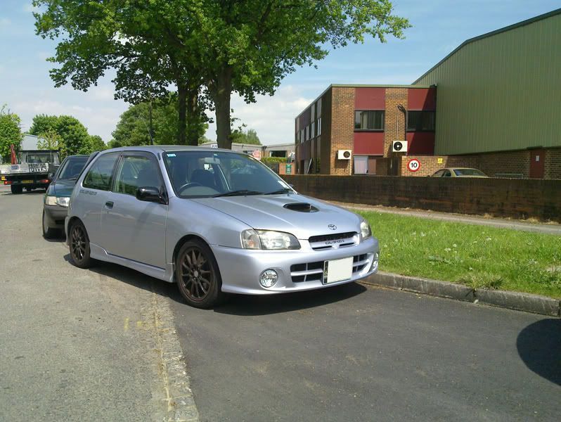

Woohoo my wheels are here :D They have black nuts & locking nuts, and are gorgeous! Hope to have them fitted tomorrow for the Brighton meet.

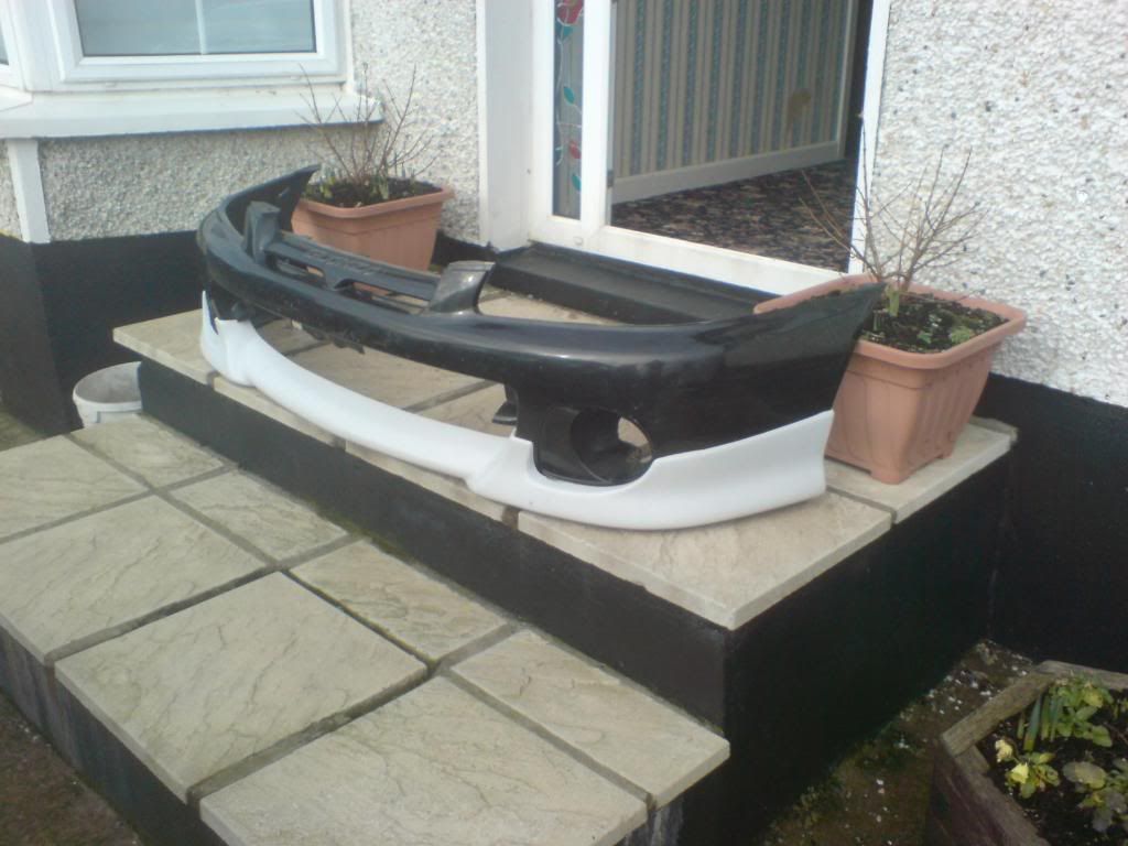

Also here's what the duck spoiler looks like fitted to the car i got it from
Here's some more of the car!
Nice wheels Al. Unless I missed it before, what are they?
Rota Grid's mate. Gunmetal with polished lip. Good Year Eagle tyres (195/45/15). Annoyingly, the centre caps do not fit over the drive shafts. I need to get some longer studs and some spacers.

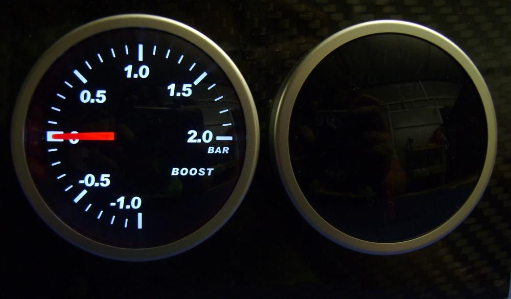

Dual A pillar pod holder for 52mm dials & a clear cambelt cover. I want to get my boost gauge connected up and didn't want those untidy dashboard mounts or fake carbon effect ones. The cambelt cover is purely cosmetic but looks quite cool.

Smoked Dials - A couple of dials like this

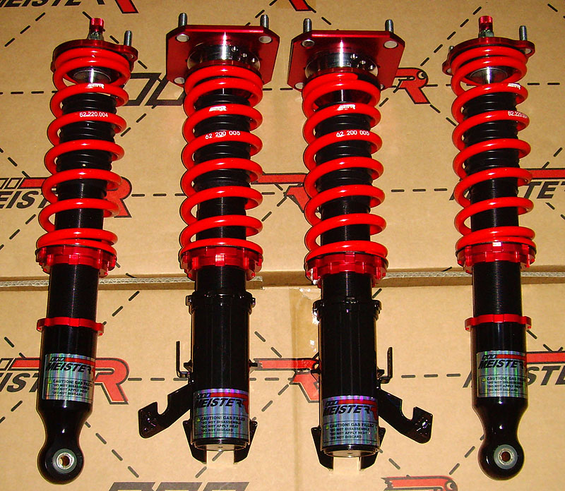

Just ordered these too, MeisterR Zeta R coilovers.

haha! The work begins Saturday. If there's enough time, the manifold, de-cat and exhaust will be fitted (with new gaskets). Will then do the coilovers & get the geometry re-done on Monday. I'm looking into getting front & rear whiteline roll bars too, just trying to confirm if they'll clear the Nur Spec exhaust (2.5" pipe). Can't wait to get this all done, i've watched clips on Youtube of the exhaust and it sounds amazing! :D

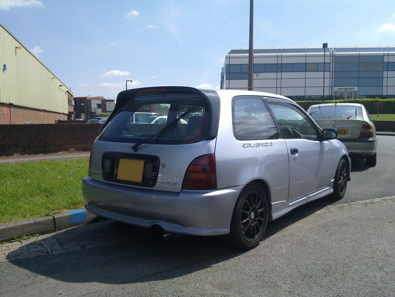

Ok, the work has begun! The Manifold, De-cat, Exhaust, Panhard rod and Coilovers are all fitted. As well as sounding awesome, it looks and handles a lot better! Still got a way to go yet but here's some more photos. Proper blog type thing coming soon.
