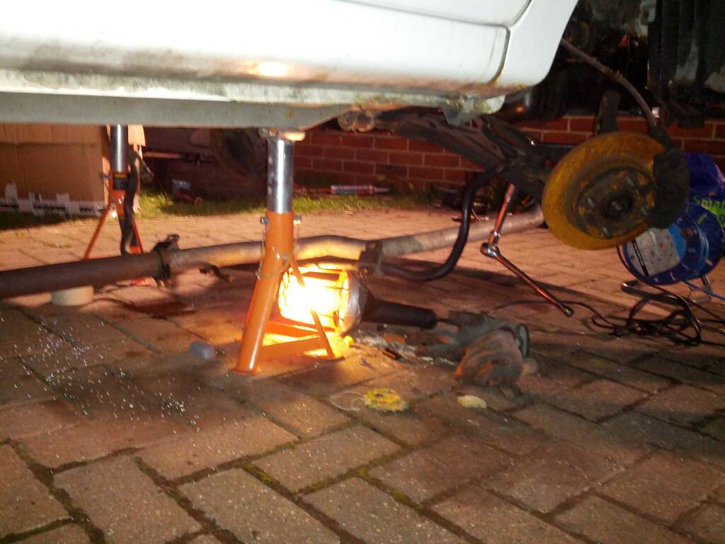

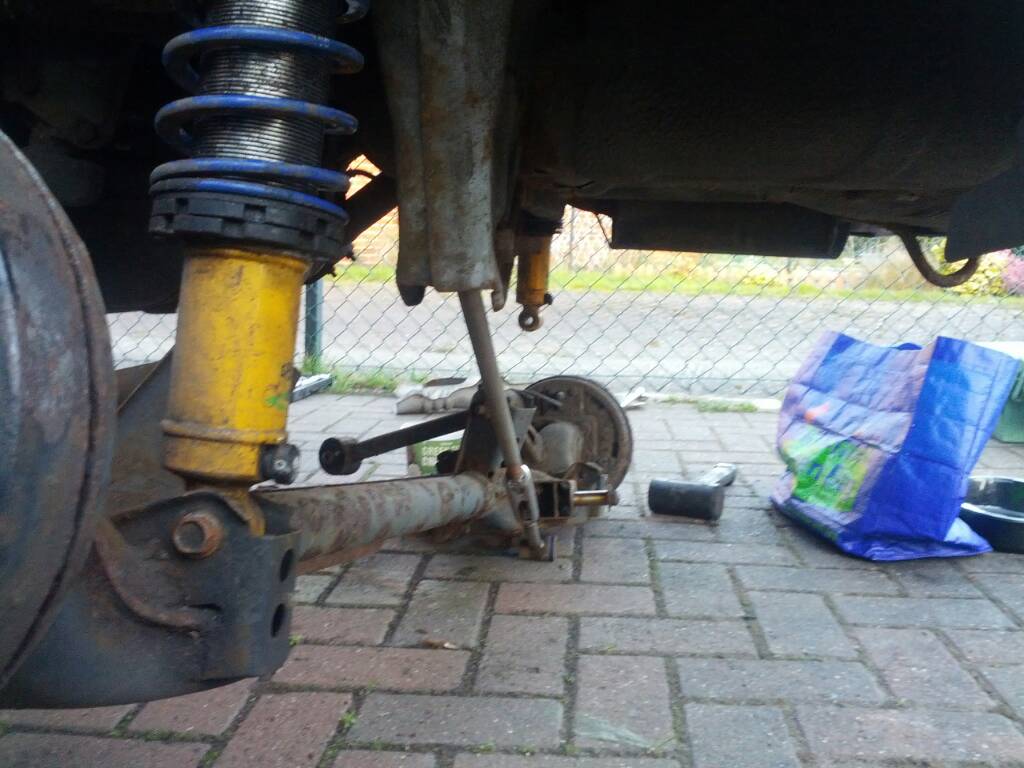

Been reading up your threads material on the rear disk conversion. Worried mine shall be seized, we shall find out eh!
Your axel looks in good nick mate, if you get "stuck" (bad pun) i've got a refurbed rear caliper sat in the garage that i never used
boob... I means boom![]()

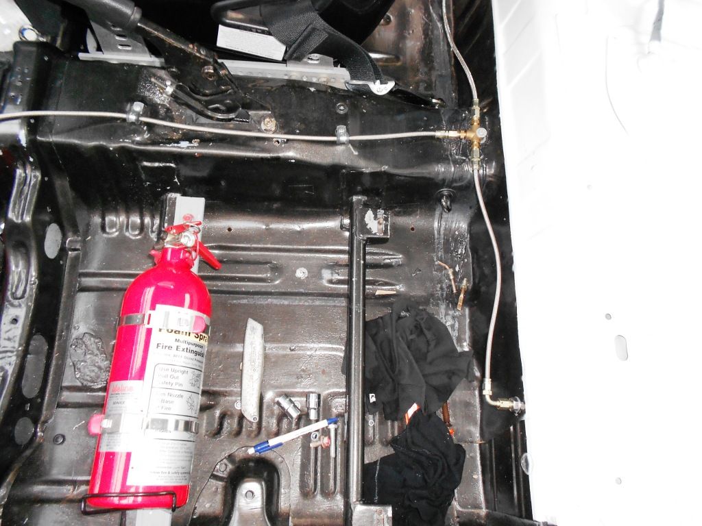

hmmm, it may have to be considered! lol stuck indeed. Guessing the rears are that simple they can just be rotated? actually no, the hand brake line means it fixed orientation. Yeah I am lucky, its not all that bad. I have kept her (axle) indoors to avoid any more weathering until I strip her down and paint. Thinking about relaying the brake lines through the shell as well whilst I am at it. Means I can add hydrolic handbrake and manual brake bias adjuster! I like the idea of relocating my lines as they are scarily close to the ground!

For the money moving the brake lines inside is not bad at all, especially if you used copper pipework... im not sure how you would get on with a bias valve & the MOT though, do you still need a split system? I originally run two bias valaves to keep mine split but ended up just merging them to one to keep it simple.
I used to run the two handbrake setup theres lots of room to fit it in, never felt much difference only the brakes bit better once up to temp![]()
Yeah planning on copper. the MOT should be fine. I think you need a split system at the least. What so you have no split in the system? lose one brake lose them all?

well u are just running it in lol! the holy **** handle you mean? got a picture of your lines in the shell and where you put them? any advice?Mines not split as we dont have MOT's here, my bias is set with a good % to the front so if i lost a rear brake id should be ok, if not it would be down through the gears & then the panic handle![]()

well u are just running it in lol! the holy #### handle you mean? got a picture of your lines in the shell and where you put them? any advice?

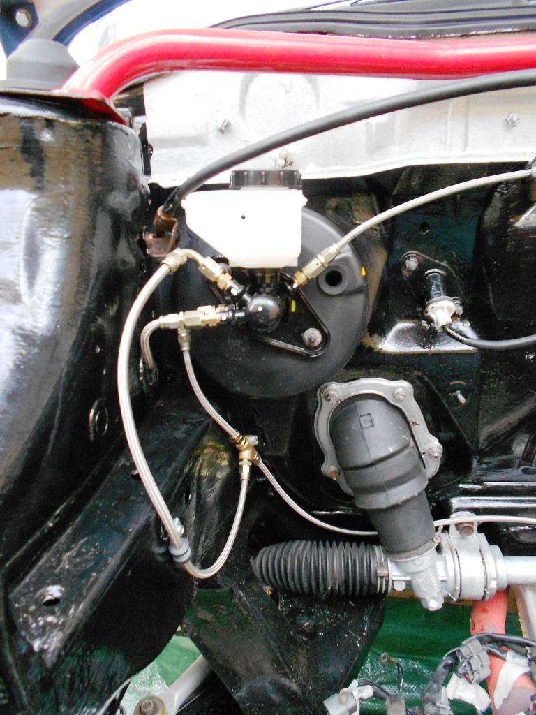

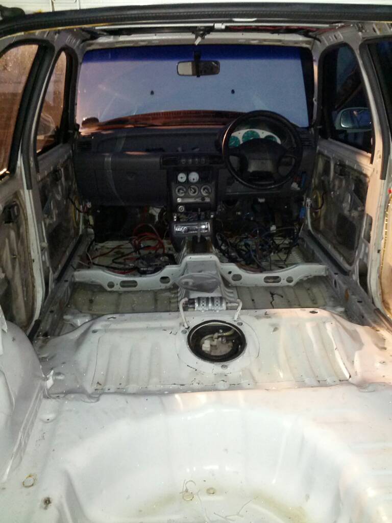

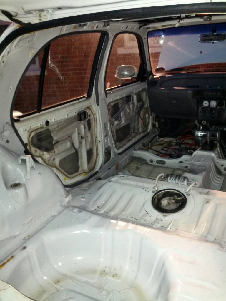

Wont be going so easy on it over the next few weeksheres the M/S:

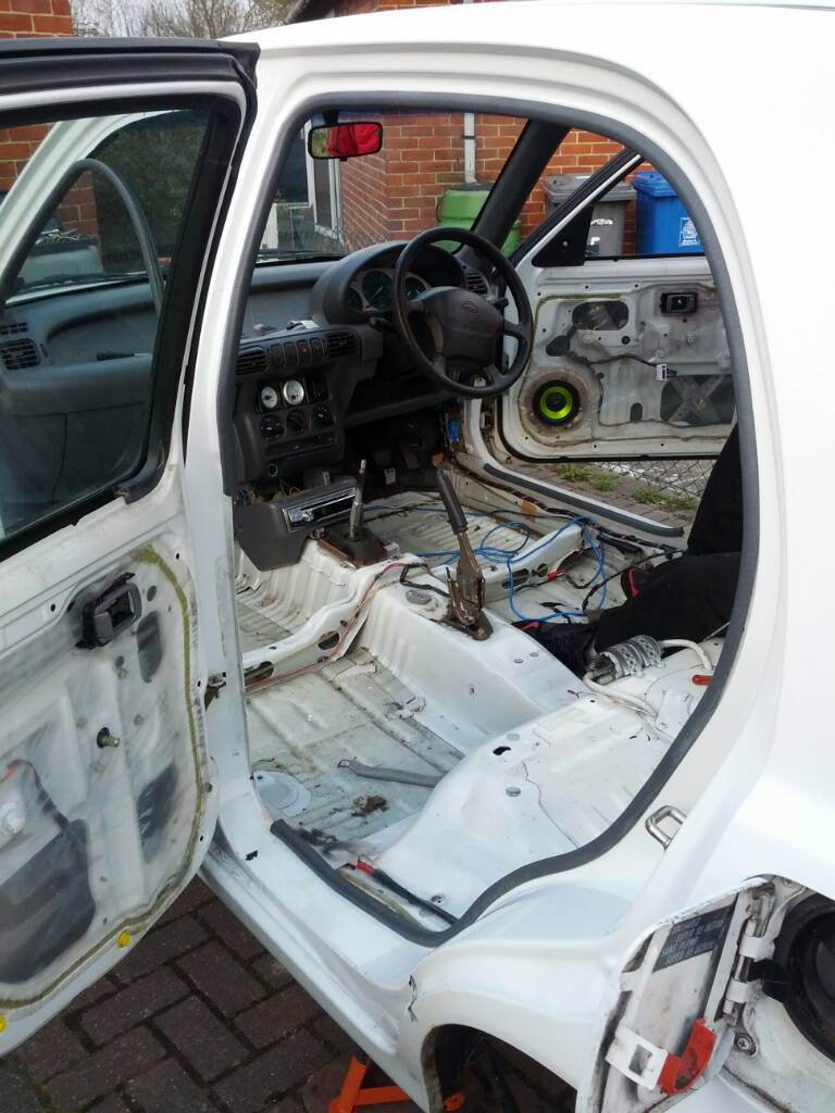

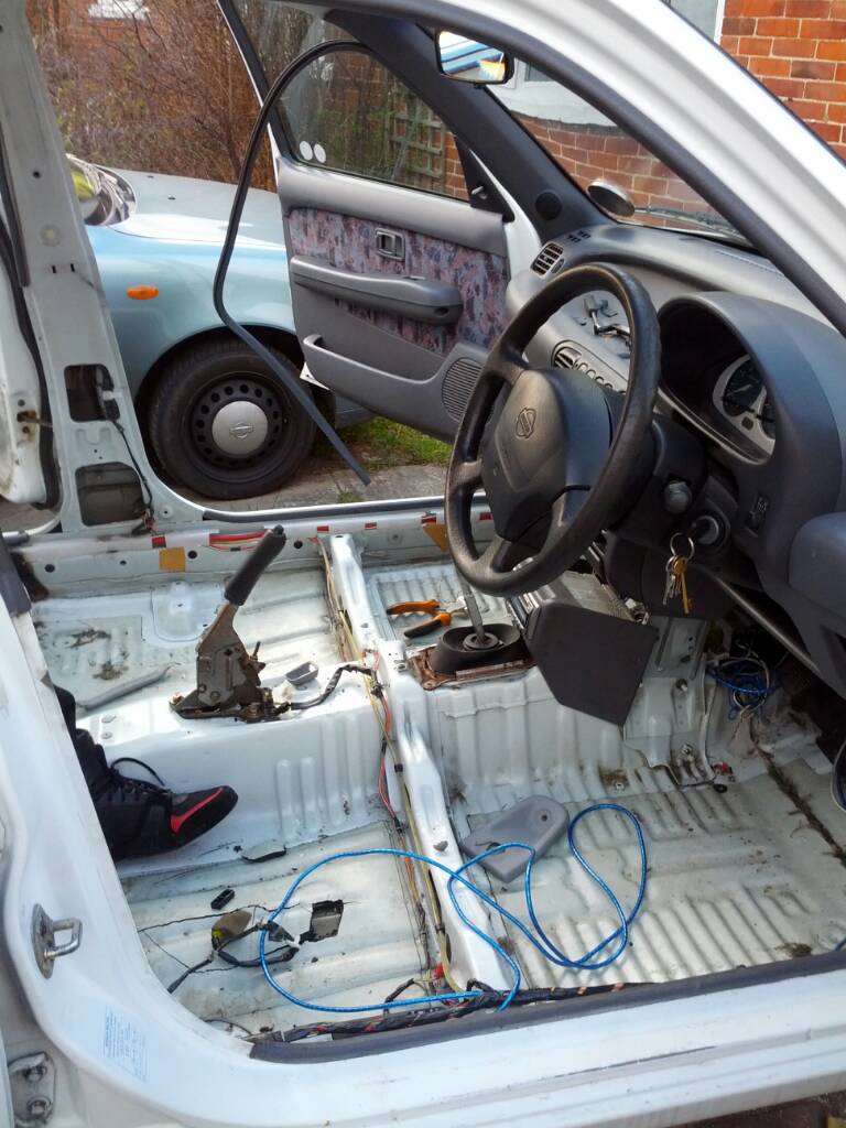

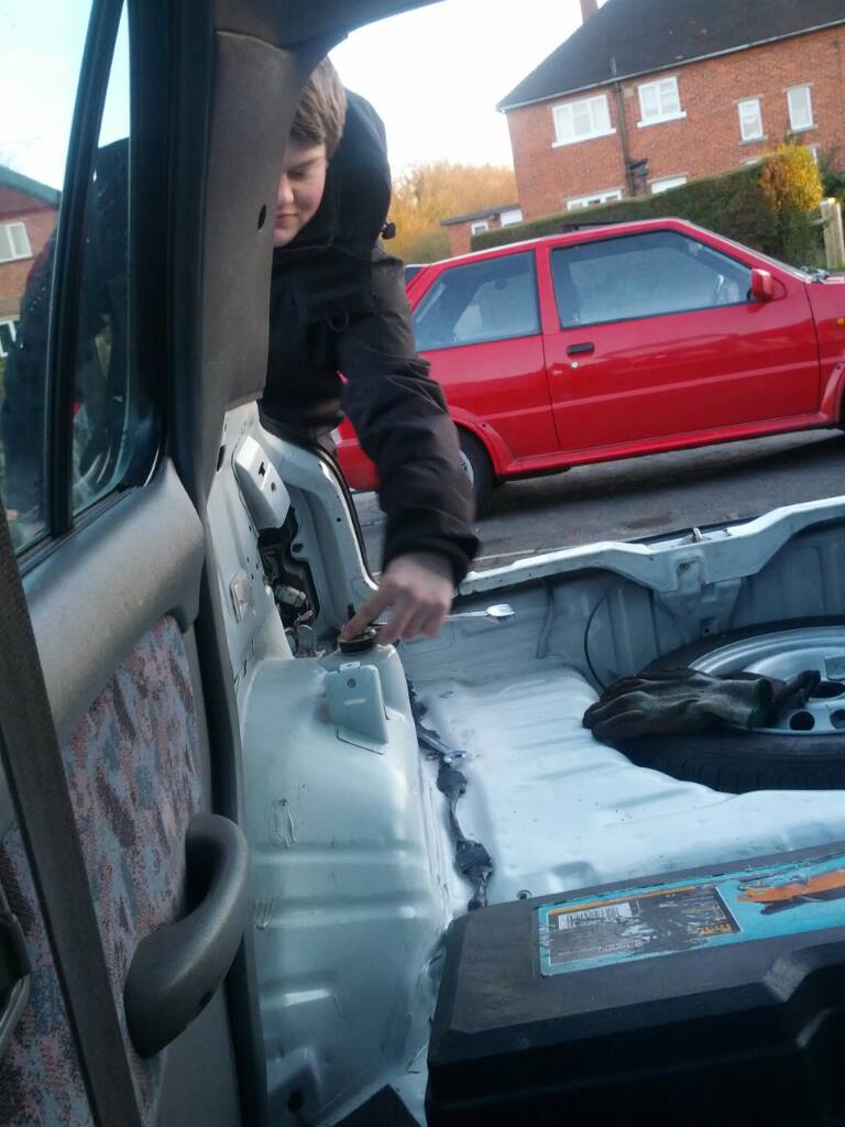

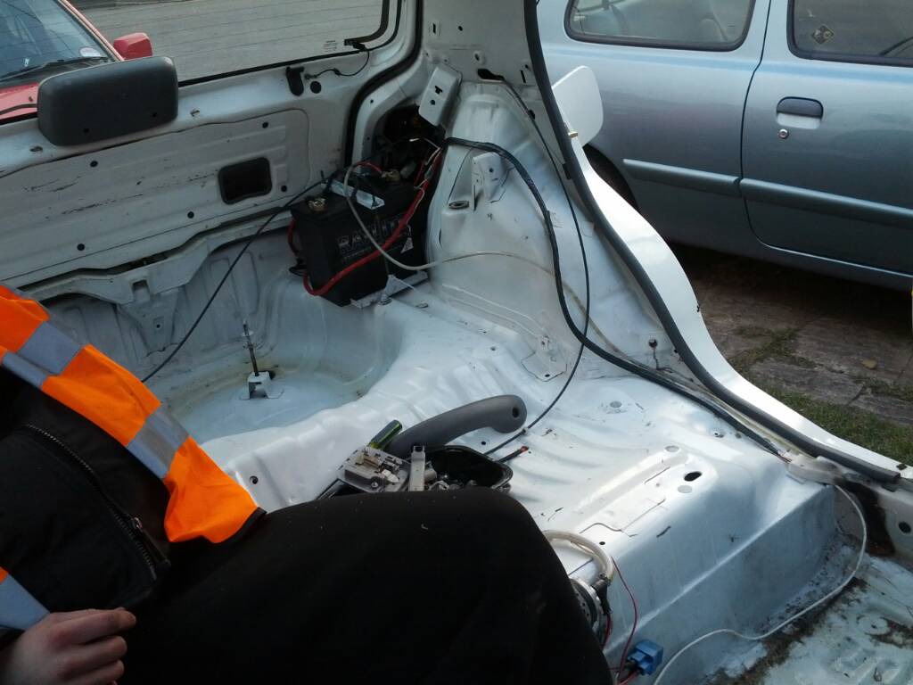

Lines in the shell:
I can get you some better pic's not problem..
Main advice would be just make sure they arent anywere they can catch on your feet or anything like that, & measure 3 or 4 times before you start cutting pipe![]()
whats that servo from?
Tell me about this, I have been thinking about playing with the master cylinder.Servo's standard Micra, the Master Cylinder is the larger bore Primera (i think) onecertainly gives a solid pedal

ah good to know.Its from Matt Humphries mate, brand new comes with the seals & fluid resivour etc.. 4.76mm larger diameter bore & is a straight swop

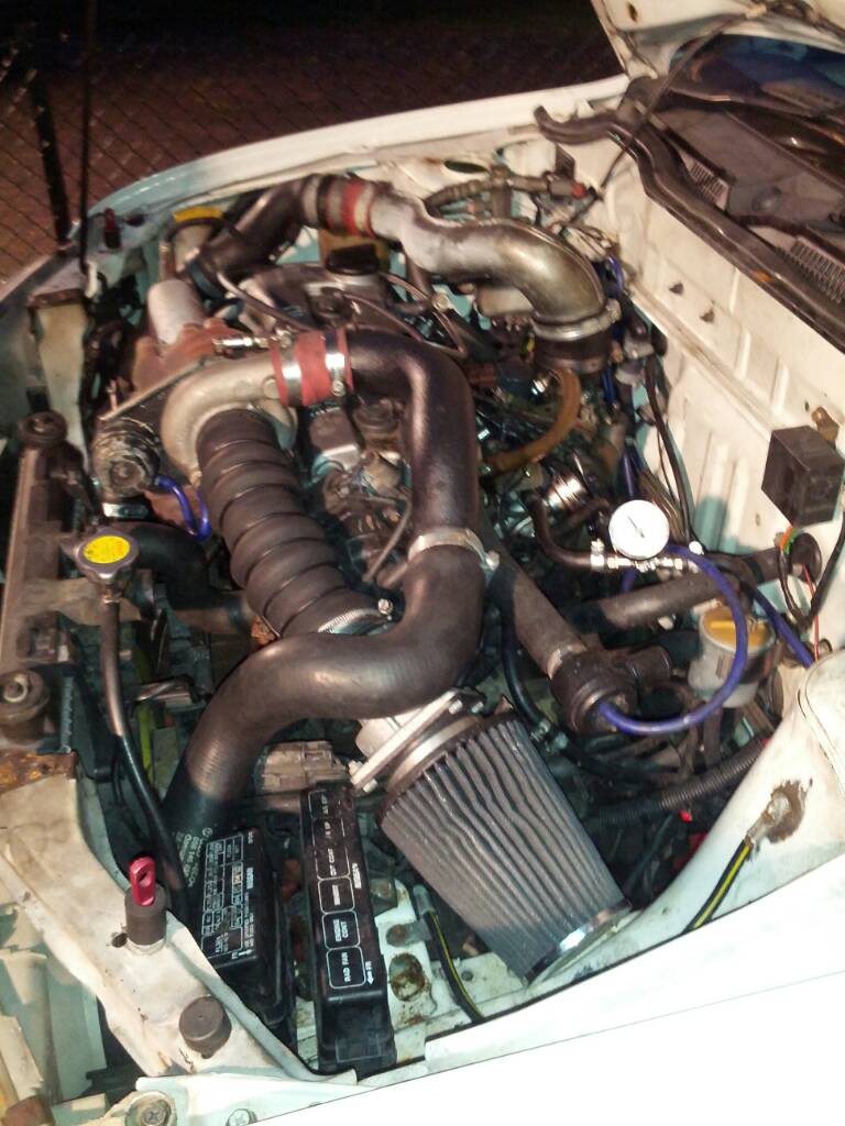

I was thinking the same thing. Not going to lie.. I love the bov noise but want t get here running clever.also consider redoing that messy pick&mix plumbing.
and either recirculate that BOV to the turbo inlet after the MAF
and/or relocate the MAF from a "suck through" to a "blow through" setup between the BOV and TB
cos currently when the BOV dumps excess air out as you shut the throttle, the MAF still registers all that air and throws a wad of fuel in but without the matching oxygen so it briefly burns too rich, prob not too good for it.

me too, mine runs far better since i went blow-through 12 months agowhether its recirc or free air BOV, I'd relocate that MAF to between the BOV and TB

Got to be resourcefulUnless iv missed something the 200sx maf is still not wired up? Are you not still using the maf in the t/b Chris? (in which case it is blow through already). I put the 200sx maf there basically as a short term adaptor for the filterI gave you the connector for the bigger maf for when you got it mapped but nothing to worry about till you do.

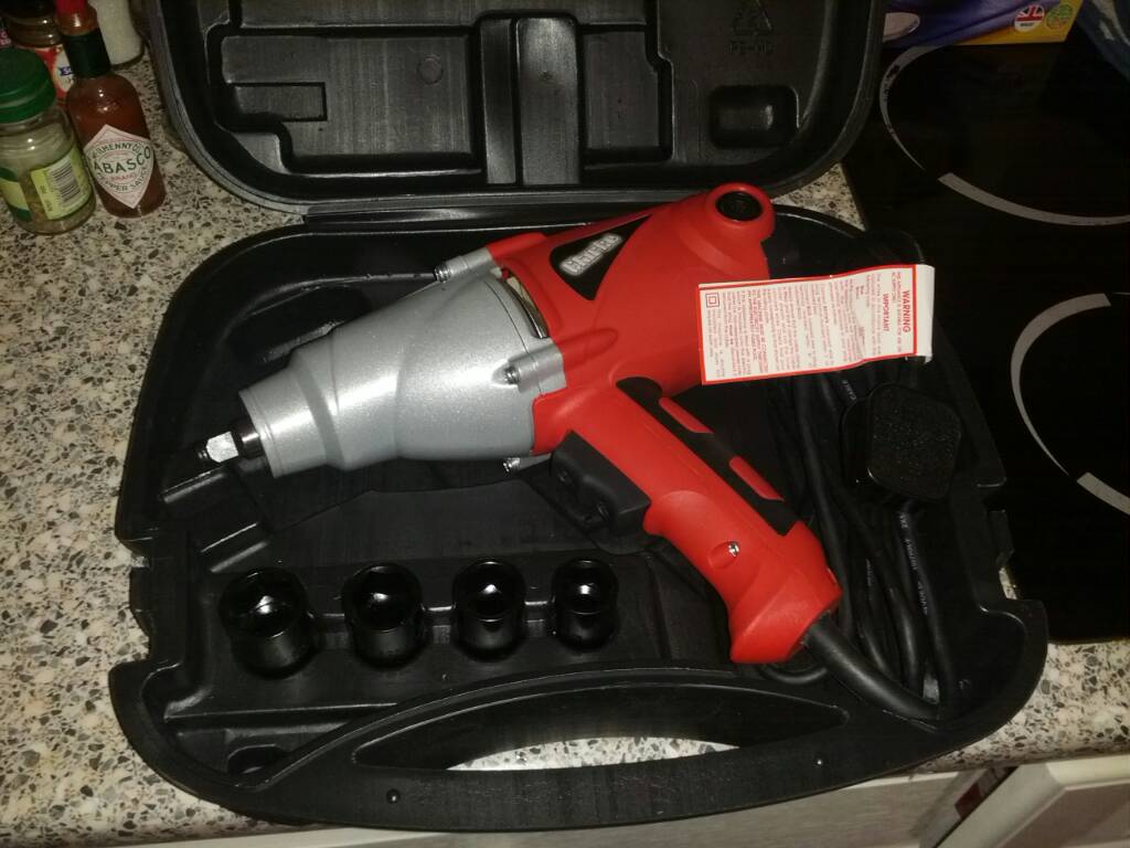

yes its massiveI've got one of these, makes light work of most bolts my only gripe is how bulky it is
