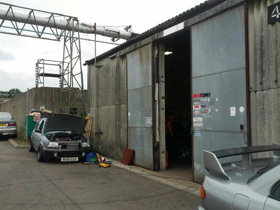

@pollyp this photo was for you actually it was in relation to when you posted your visit ages ago![]()
Dyno is tomorrow. I have been getting the maf and injectors in.This thread is useless without dyno printout![]()
Booked tomorrow afternoon off, when will you be back from blowing up on the dyno?
