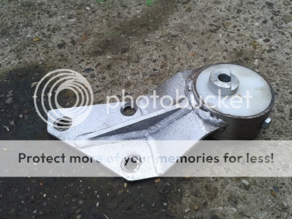

Yeah I did is that bad. The weld was still glowing when I continued.looks ok, assuming you stop started part way along. I'll give it a clout tomorrow with my hammer and see if it budges
Chris.. you done goodYeah I did is that bad. The weld was still glowing when I continued.
Thank you very much mate.Chris go away and get the job done the welds look good! Amazing how far youve come in a year, I guess we were right in ordering you to get stuck in and not look back

VERY nearly as good as mine, I think you're worrying too much about welding those floor plates in with welding that goodSorry just to try and get everyone's opinion. Those welds are fine?
Catching me up tooVERY nearly as good as mine, I think you're worrying too much about welding those floor plates in with welding that good
Shut up you plebs don't take the piss no where near yours. A lot more practice is needed.Catching me up too![]()
I have belted then with a hammer and they really don't ring like yours.VERY nearly as good as mine, I think you're worrying too much about welding those floor plates in with welding that good

I battered them silly with no budge. I still don't know where the limit is on things with welding. I have no experience to gauge from if that makes sense. That's why I want someone to check. So when I do it next I know what the weld should be capable off. You get me? Lol I am not being a pussy out of being a pussy lol I am being a pussy out wanting it to be safeYou check your seat rails... where's your hammer?
Get some pliers on them. If the plate starts to bend before the weld breaks you're good.I battered them silly with no budge. I still don't know where the limit is on things with welding. I have no experience to gauge from if that makes sense. That's why I want someone to check. So when I do it next I know what the weld should be capable off. You get me? Lol I am not being a pussy out of being a pussy lol I am being a pussy out wanting it to be safe![]()
OK will try. I did it with mole grips same thing no? The seat rail bent and nout elseGet some pliers on them. If the plate starts to bend before the weld breaks you're good.

PerfectOK will try. I did it with mole grips same thing no? The seat rail bent and nout else
