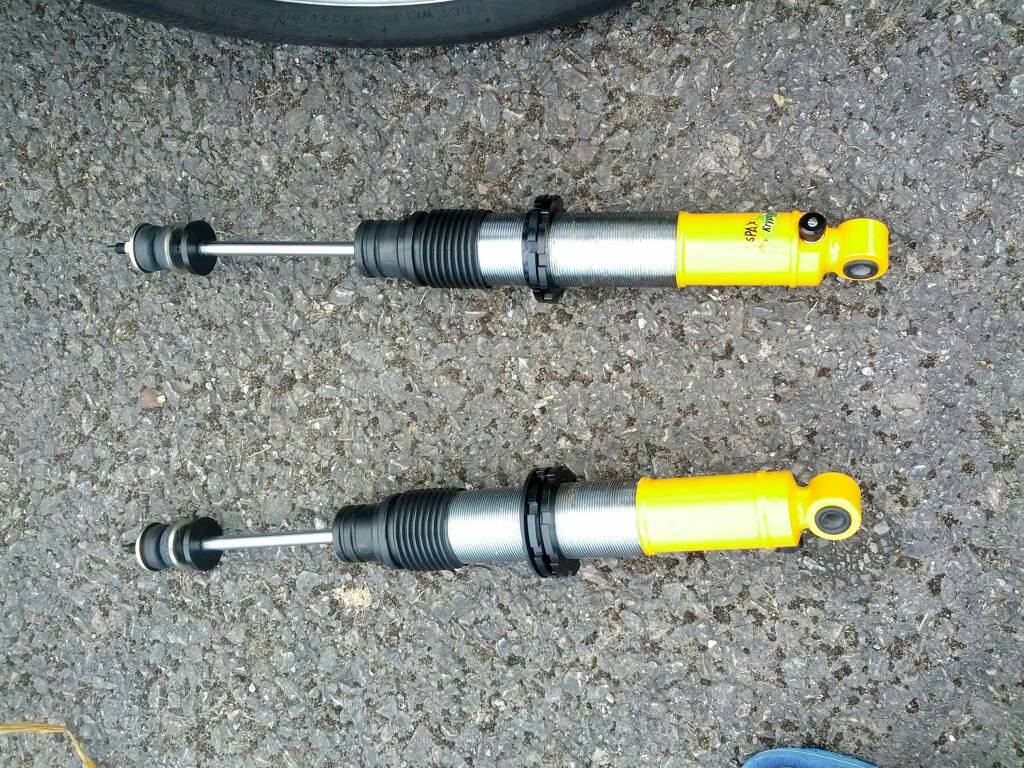

well she has been put aside a little bit as I have just moved. Looking at getting a decompression plate come the 15th. Will be servicing the brakes as the pots are not supressing fully.. no doubt some rust is in there. Also getting an AFR. I have had to correct the the timing as she was running a little retarded. Cut the rear springs and installed full coilovers on the rear, so she sits nice and tight on her arse. Need to bring her front up to match the rear. Any suggestions on making the rear super tight? remove the helper spring?

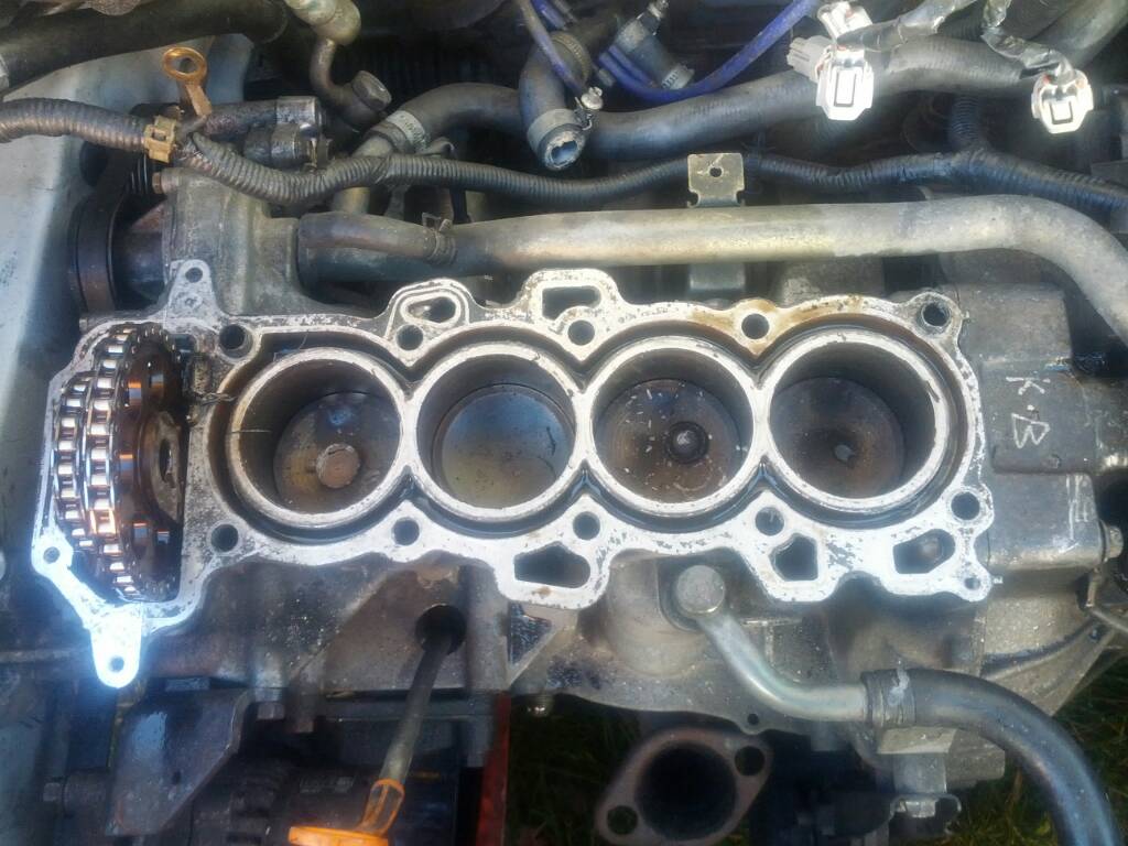

So... I did the timing wrong...well you know a bad mechanic blames his tools... I had to tools besides me, george and scott.. two k10 msc members distracting me and well what happened was not good lol. The valves planted into the pistons. Well I bought two heads from Bellys scrap connections and sorted a complete jobbie. Well at least i now have valve spares and what not! yay. Nearly there to rebuilding her. I am learning as per usual doing all of this. Had one pain in the arse of snapped studs in the heads I just bought. I think I may get away with it. Wish I could of put more effort in to the engine rebuild, no space to work. Miss my old shed.
Dude the chain tensioner. so you push it in and twist yeah.. then place in... does the chain sit on the tensioner of center of the orange slip plate. Frank you about to see this?
yes twist and lock chris, and the skidmarks on the tensioner are rarely straight, and dont forget to push the tensioner fully in to release the ratchet :)
So twist and lock. The skid marks were off centre e/g {-------|---|---} issue? it seems if the tensioner would be better flipped 180...leaving a some space away from the guard and more towards the body of the engine. Really just push it in??? with the chain in place yeah? so it dont come out too far? Frank what do those valves and pistons tell you? Lean?
thats why you turn it by hand a few times just in case!!
yes push it right back once fitted mate, and that will release the spring, and the valves and pistons look a normal colour :)
