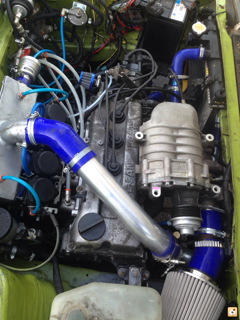

I thought I recognised it. I was going to buy one a while back. Seems to have served you wellIts an SC12 from a MR2, yeah there's a bit of weight to it.
I thought I recognised it. I was going to buy one a while back. Seems to have served you well![]()
Spot onSo far its been pretty solid, in fact (and i'm probably tempting fate here) the only issue i've had or maybe the only issue i currently know about lol was from a drive belt being destroyed after a bolt backed out and even then i can't really blame the sc for that.
It's done what i wanted it to do and that's about all i can ask of it really.
