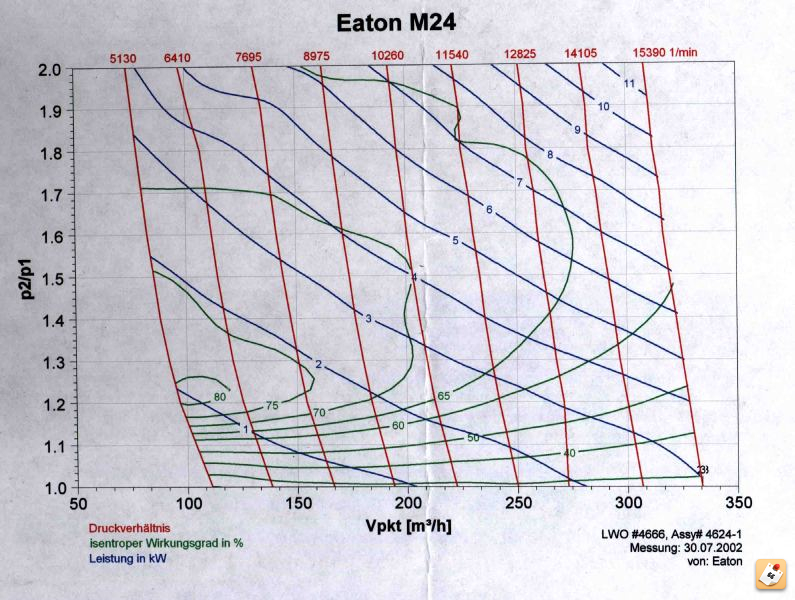

So using this map of an m24
Can wa determine if it's suitable
Care to explain that graph to me :/
It's like thermal efficiency at pressure, rpm etc and temperature rise. That sort of thing. Can use it to work out how big an intercooler you need, when power will start dropping off in rev range etc with it iirc
Sounds useful. I wouldn't know how to interpret data from it though. The fact I can't read the units of measure because they're in german doesn't help :p
So technically its pressure ratio
I assume that this will be related to the cfm of the head?
Or
Is it related to the construction of the 2 manifolds, turbo and plenum etc etc? In which case we can directly affect this by modifying a plenum for example
