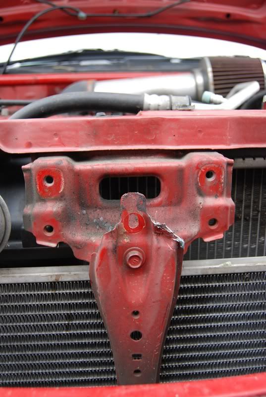

there are two rubber bump stops that the bonnet shuts down onto, located on top of the upper front panel area just behind the headlights. check the left one isn't higher than the right bump stop. with wd40 they can be adjusted by turning em.
robert
theres a steel strip/bracket from the bonnet catch down to the x member with a 10 mm bolt at the bottom, either slot the hole or drill a new one about 8mm above it.
yes thats the bracket, you can slot the top 2 a bit more if you want, i,ve always done the bottom one myself, it just looks a bit more professional sort of!

Whats the best thing to do it with? Dremel or similar?

Just been out and took the catch off, the bonnet shuts fine when it's off so it must be the catch at fault.

Had a go with the file at work today and got it sorted, The catch has brought the bonnet down to were it needs to be now :)

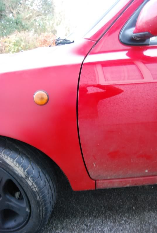

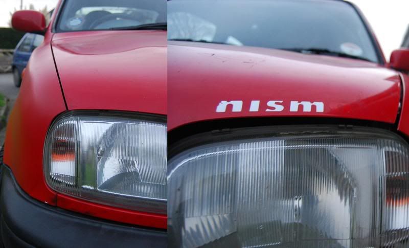

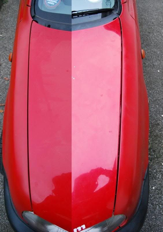

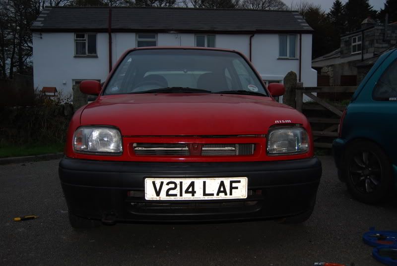

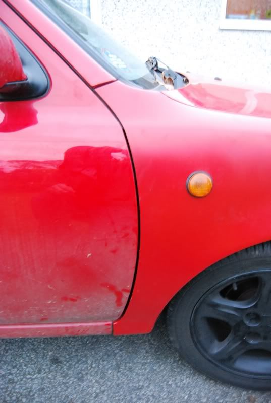

Here's some pics,
Passenger wing/door:
Driver wing/door:
Bonnet/wings from the top:
Bonnet/wings from the front:
It seems to be sitting too far forwards on the drivers side, too far back on the passenger side.
And slightly to the drivers side in general.
The bonnet is also still ever so slightly too high, Just need to grind out a little more to drop it down though i think.

Looks good though Robert, Is the rubber bonnet blocks all in their places/ (Not sure if it'll change anything, but worth a try.)
robert
they look pretty good to me !
you can take the whole bonnet to the n/s a touch if you want by tapping the metal loop/catch on the underside of the bonnet to the o/s a bit (it,ll angle it slightly !)
the n/s h/light to bonnet gap looks a bit wide, it,s a job to tell on that pic ?

And yeah, the gap between the light/bonnet is pretty big on the n/s, the light itself isn't fitted quite right.
