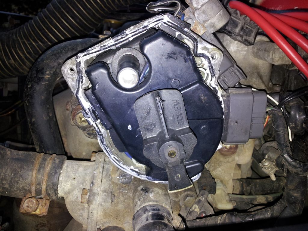

Remove spark leads and distributor cap - 3 screws to find
Remove this screw and slide off the rotor arm.

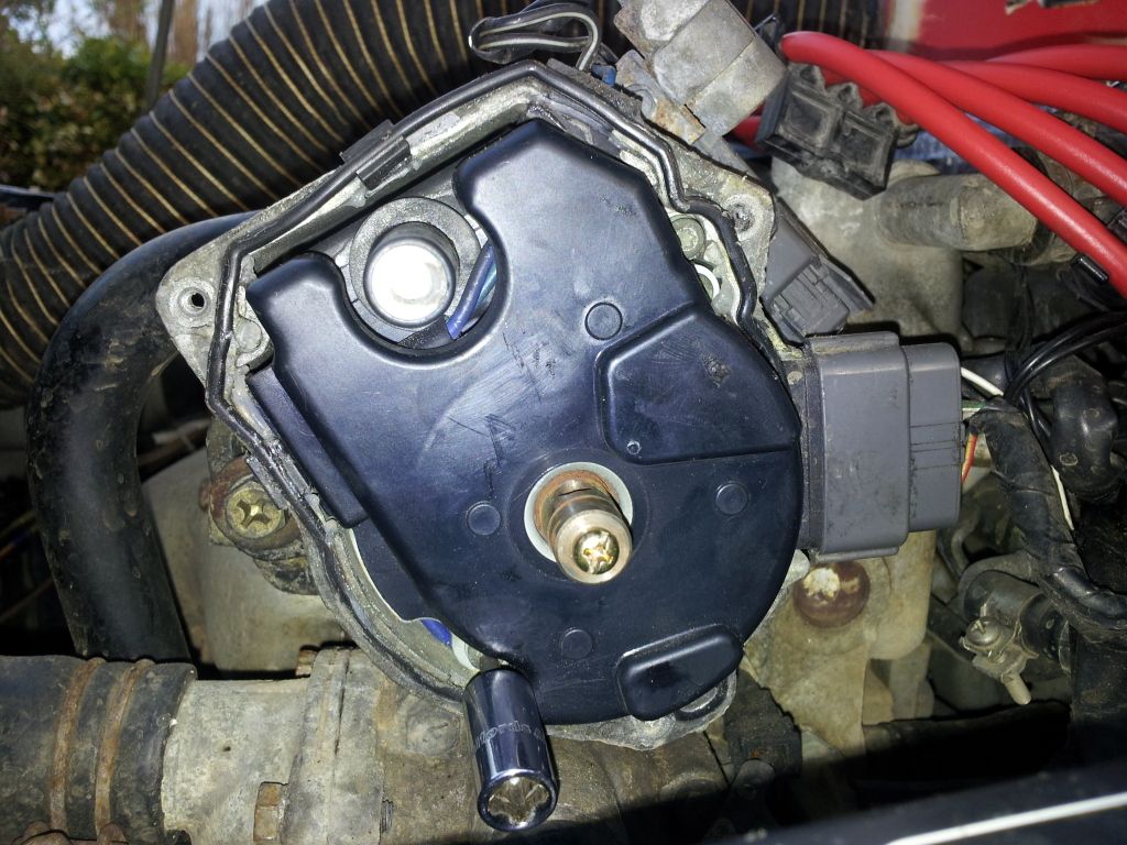

In my frustration this plastic cover nearly got snapped off but it's secured with two torx screws @ 1o'clock and 7o'clock (with bit shown in it.)
Then remove the screw in the end of the shaft.

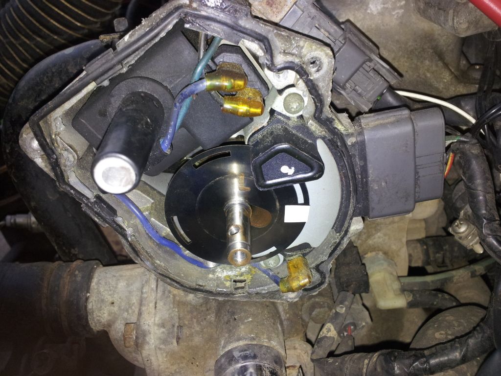

This is what you find. The slot in the disc allows it to slide out from the sensor. Hole covered with tape wrapped around the edge and stuck to itself through the hole.

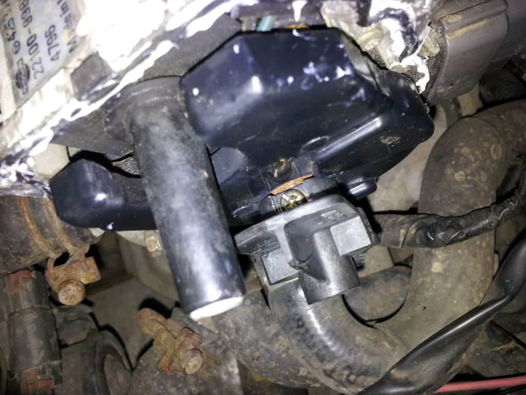

Go back to first pic and see a smear of silicone sealant on rebuild to help the rubber weather seal.
This one done with electrical tape.
