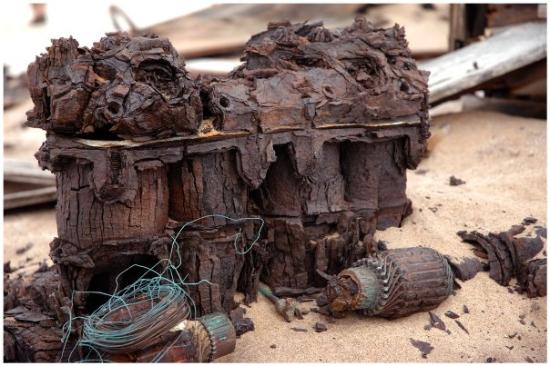

My cg is a tiny bit better than that haha
I see the resemblance thoughMy cg is a tiny bit better than that haha
Hate cg engines, their ####!
Will look like that after I set fire to it tonight when I get pissed off with it hahaI see the resemblance though![]()
