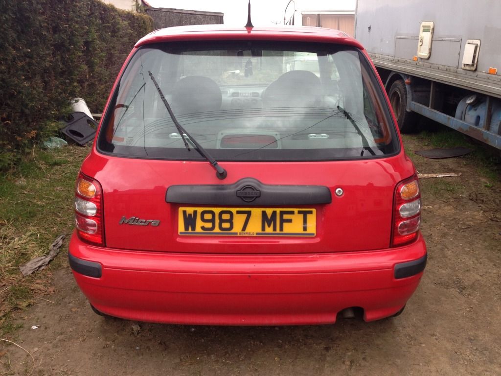

Back of Matilda so far, at this point really the only thing that's been done is the removal of the celebration badge, the blacking of the Nissan badge and new back lights courtesy of CraigIC and his dad, they're Taiwanese imports as i'm sure you're all aware, i think they suit the car. As a little extra there's a snail in one of them, how he got there i do not know!

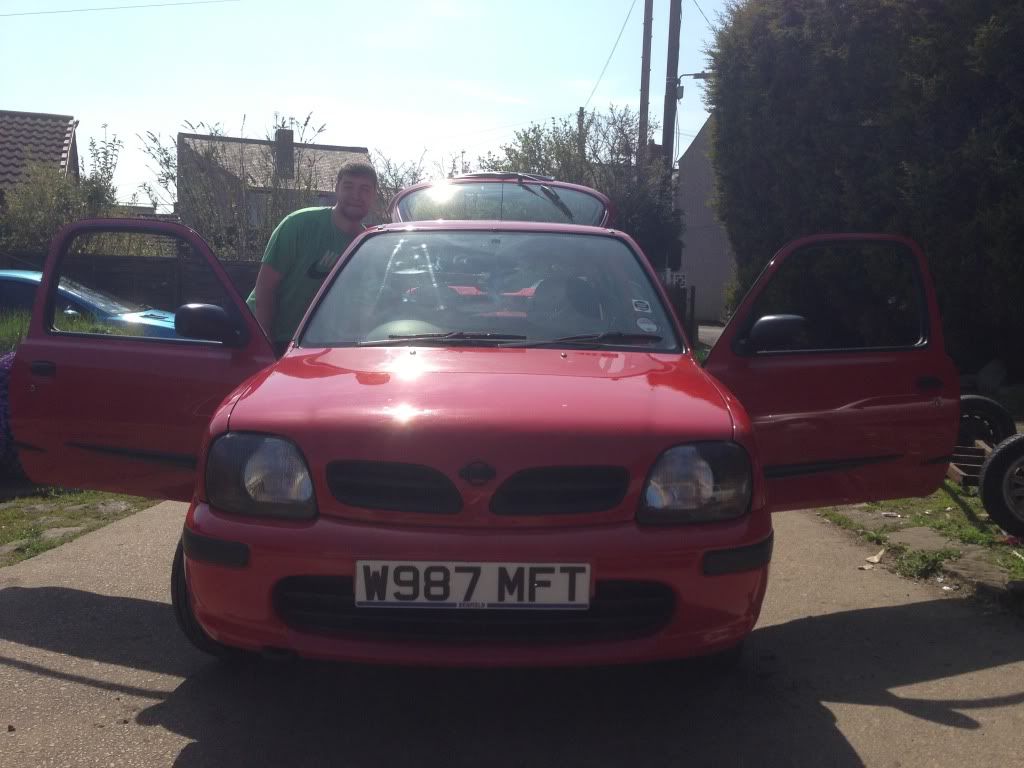

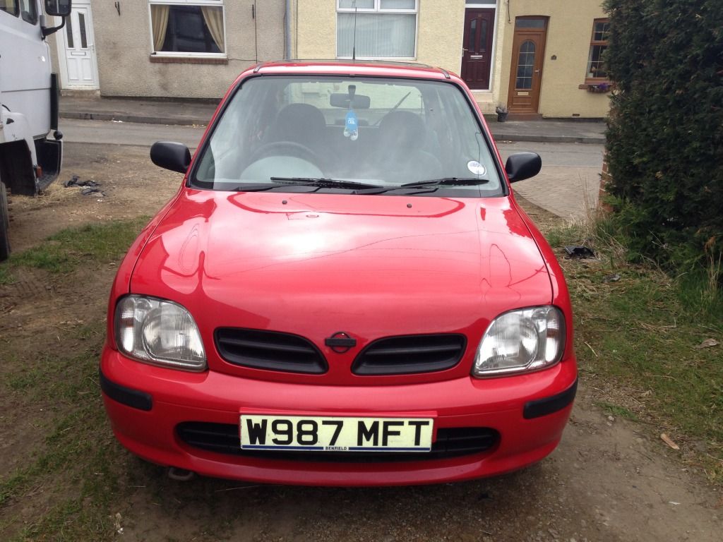

And this is the Front, blacked out Nissan badge and matt blacked my grills. Chrome wasn't really my thing. I don't think it looks too bad right now. And yes, that is a dent in my bonnet, it's actually quite a funny story. Had bonnet up doing some tinkering work with CraigIC's brother, he had his tools on the top, i stupidly shut my bonnet to let his Dad out and dented it from the tools on the engine. Then, his dad decided to try and take my dent out with a hammer, missing and causing a dent next to it. Guess that'll be to sort at some point.

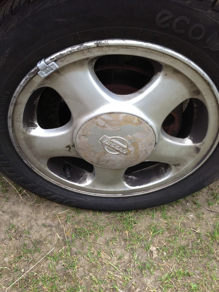

I've also got some cheeky alloys added to the car, started off with some bad steely's i didn;t have any pics of, they were tie wrapped (tie raps??) on and looked awful, so anyways here's some pics.
So these were the rims i received, for a swap of my steely's and 20 quid, bargain really. Yes they're shoddy in the middle and all that black stuff? that's 13 years of break dust and grime literally baked on, it took me SO long to get them cleaned again. I don't care though, they're my rims now and to be fair, they're not a bad set.
and this is how they turned out. looking nice and fresh (ish) again. They've had a spray in the middle centre hub thing, and i cleaned the spokes up. It took me a good hour or so to get them like this. Some may be wondering how i did it and to be honest you guys will probably cringe at how i did it but here goes. I had a bucket of hot water and added some household cleaning stuff, some washing up liquid (for grease) and a good glug of vinegar for acidity. I then used a floor scrubbing brush on em to get some of the thick off, followed by a normal sponge and scourer to get some of the finer dirt off. Eventually i resorted to a metal pan scourer which really got the dirt off. After this thorough beating i finished with a nice micro-fibre alloy cleaning brush and clean water and i think they came out beautifully.

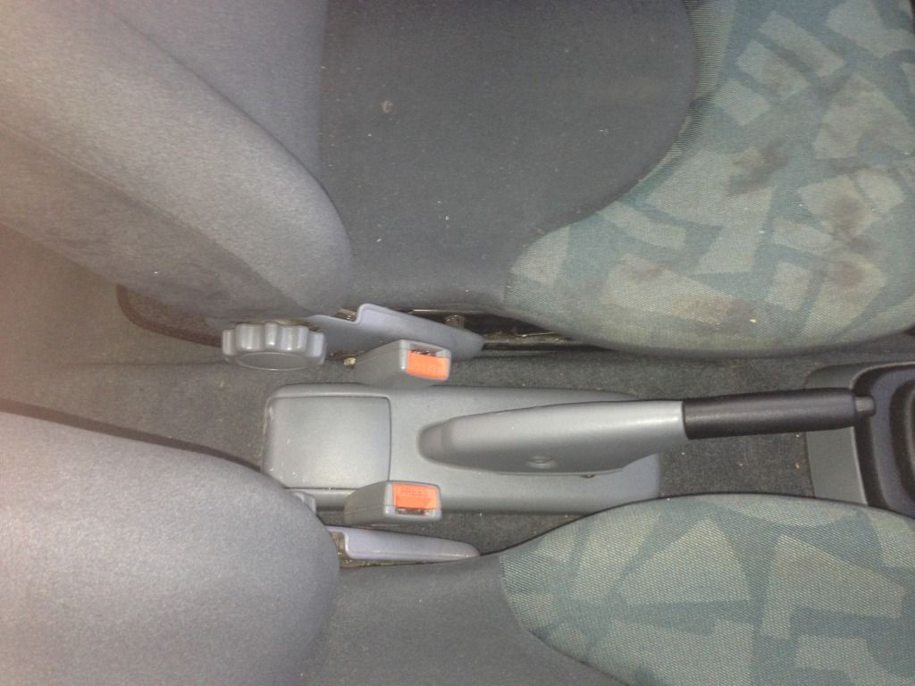

And this are really the only two pics i have of my car interior. Yes i know, they're awful, grotty and quite frankly embarrassing, they're one of the next things on my list to do, when i actually get a chance to do anything on them. First a good clean and hoover i think, generally though they don't look too bad when i actually am in the car.

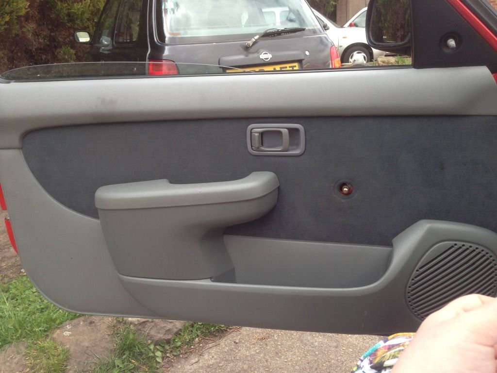

Before (with handle removed)
And after! Personally i think these came out awesome, was dead cheap to do and to be honest after the initial thought process relatively easy.
so Above are a few pics of what went on. basically, remove plastics, cut fabric to size, glue, fold, and on the edges put some extra cuts in just to make it easier and neater. It took probably 2 hours to do both door cards and the end result looks awesome in my opinion. Amazing what a duvet cover can do. for those of you wondering, the arrows just point to screw holes to make em easier to find for plastics.

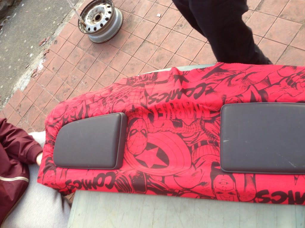

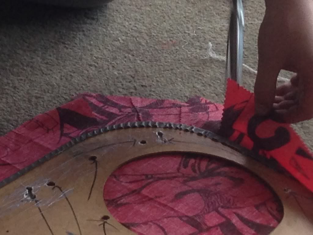

The next order of business was to do my parcel shelf, i still had a load of the red fabric left over so i figured it would be the best thing to do with it. To be honest for anyone who would think about this it's hard to do. It took us a good few hours and to be fair it's still not complete and we're still not completely happy with it. Anyways on with the pics.

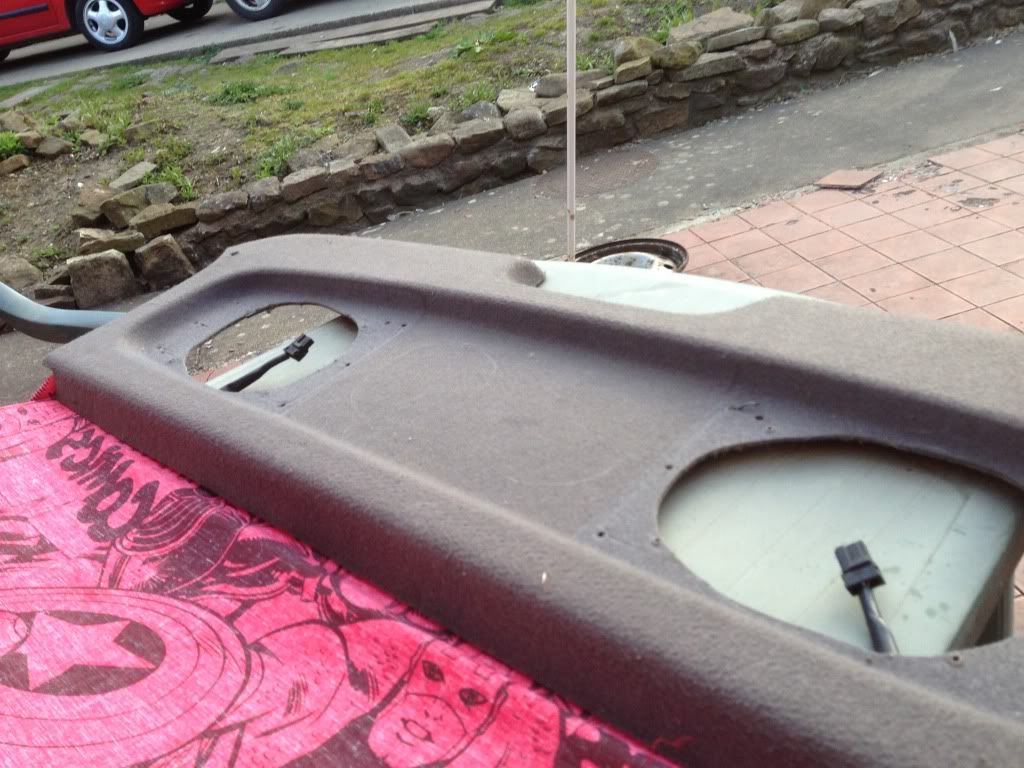

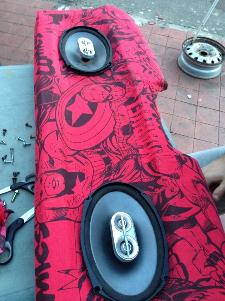

This was my parcel shelf before, looks shoddy, and i know this. holes badly cut to fit my 6x9s i was given off a mate, surround holes where the grates go over from standard parcel shelves, even 2 circles marked where i was gonna cut out and fir the standard micra ones before i realised i was being a ****. Thank god it got covered.
So start of the process, glue on the undersides, then stuck and folded over
Yep that's all glue, because of the flock/fabric stuff it needed loads on to get it to stick. if you note dip in the middle with loads on, it needs it, it will sag and look awful.
And this is what it looks like at the end of it all. it's still not completely finished though, the centre bit where it curves in hasn't been stuck to the back, but for now it will do. I reckon grills over the top when we get round to it, took a mock up of it just to see what i thought.
i definitely think grills will go over eventually.

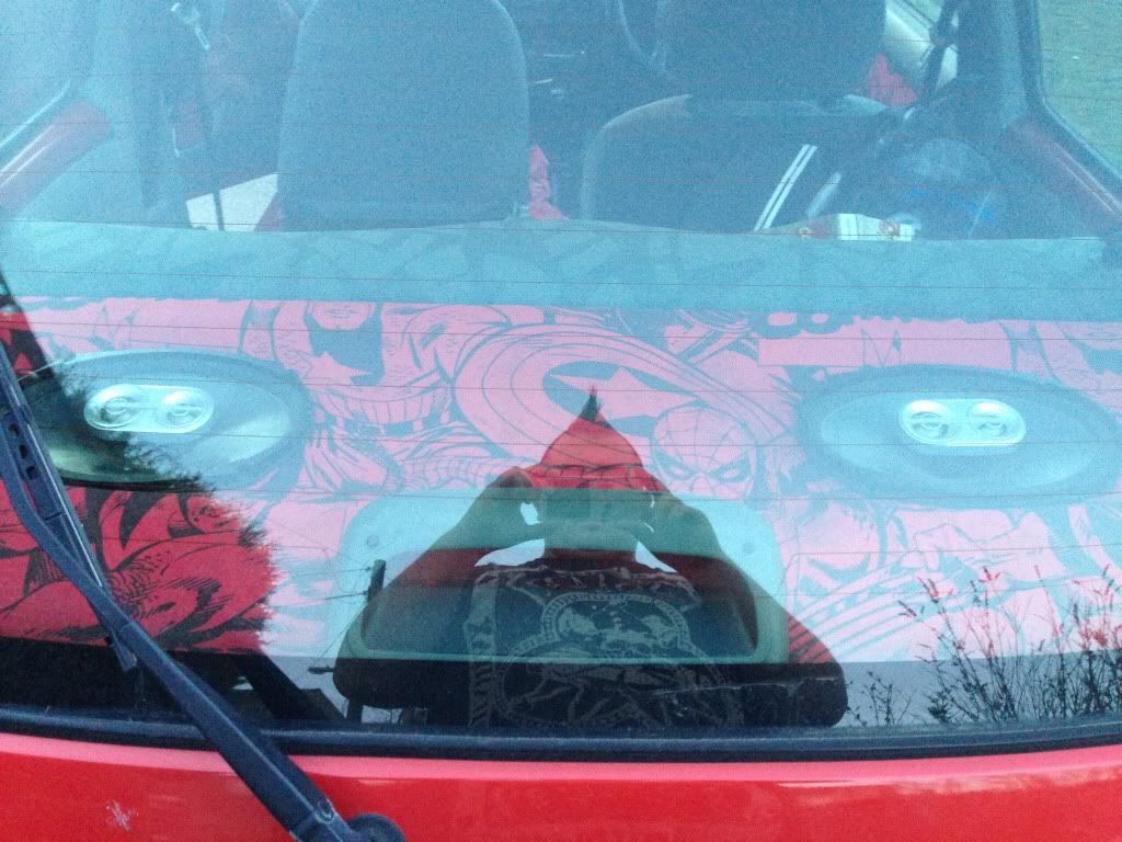

And that's it through my back window, looks pretty sweet if you ask me. I'm very, VERY happy with how it turned out. Will try and get more pics when it's finished. On another note, i have one final piece i want to do and that's the sun roof cover, does anyone have ANY ideas how to remove it and replace it?

How did you get the door cards off along the top edge? I can get all mine unclipped and then they just don't seem to come free from tje seal by the window ? :/
Sent from my sofa eating lasagna and watching tv
When I did mine it needed some wiggling and a good tug!
I ended up pushing from underneath and pulling from the top. It gives eventually.
There are two screws behind the inside armrest/handle, and one screw behind the door opening mechanism on the doorcard.
Have you got both the armrest handle, and opening mechanism backing/surround, off?
Remove those screws, then pop off all the clips from along the bottom and up the sides, then the top should pop up and off..
...a good tug!
As skymera said, might take a little bit of gentle persuasion! It should all come off as one piece!
Yeah ive got all the screws and clips out but it just swings about on the top edge , looks like ive just gotta put a bit more force into it :) cheers guys :)

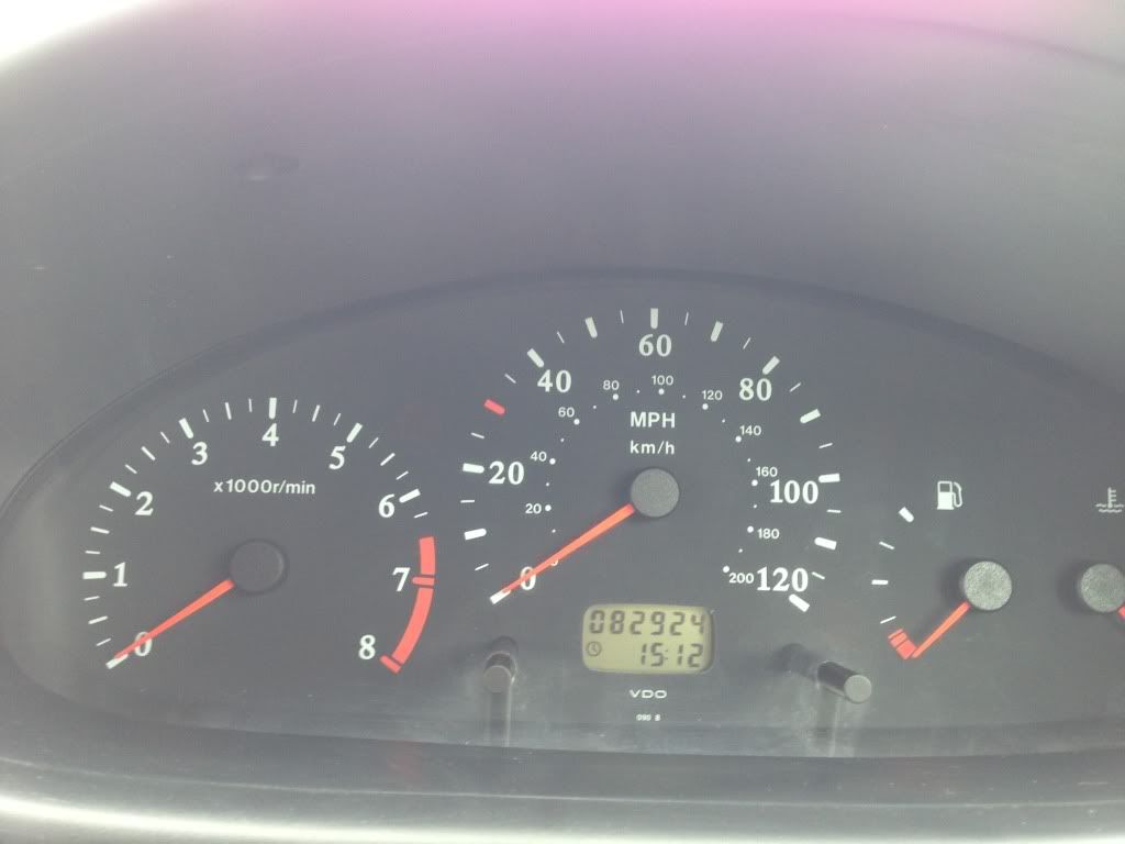

Alright guys, well as CraigIC and Chog have been saying there's stuff in the works. I didn't wanna really updater until i had more, but well with you all being update whores i figured i'd share a little swap over i've done.
from this
To this bad boy.
So now i have a lovely rev counter. (with slightly less miles). If someone had told me i'd be adding a rev counter and only unscrewing 5 screws i woulda told them to shut their butts, but it literally is 5 screws and putting a block into a slot in the back, seriously easy and look MUCH MUCH better. Only a small update for today, and sorry for not replying sooner, it seems no one replies according to my emails. Cheers Chog and CraigIC for picking up the questions.
