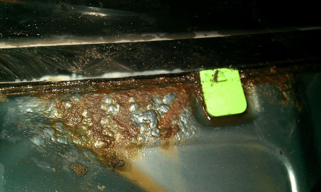

Thanks for these posts, I had damp in my K11 and it got much worse than past few weeks (the seats were damp from the condensation every morning) and realised it was only the passenger floor. Yesterday evening (in the cold) I removed the scuttle panel cover and found the clip and surrounding area was pretty rusted. I pulled it out and sealed it back in with lots of silicone (and sealed along that part of the screen too, just in case it had rusted under the seal), hopefully it should fix it for a good while!
Pic:
