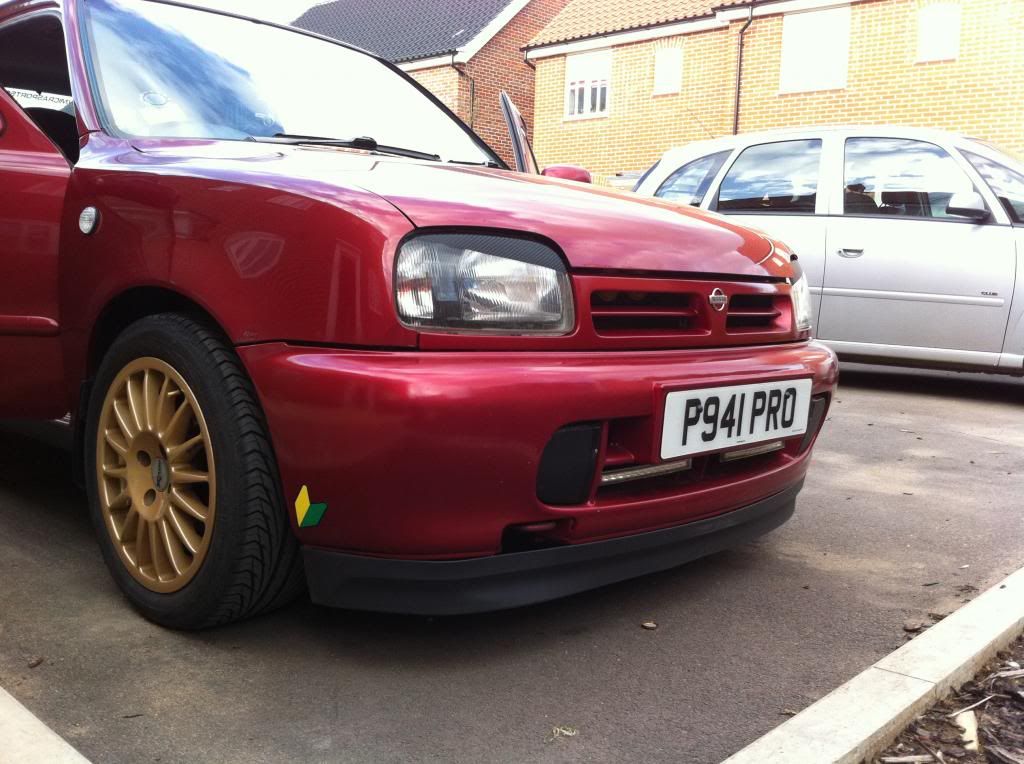

You should redo the bottom of your open grill doesnt look very straight.
Looks clean other than that! Taiwanese rear leds looks good with the color of your car. Good job overall
(I don't have a GTR badge... Anymore and even if I did it was because I have a sense of humour.
The grill isn't straight at all well spotted it's just something else on my list to redo... Or get the nismo one. Honesty appreciated.

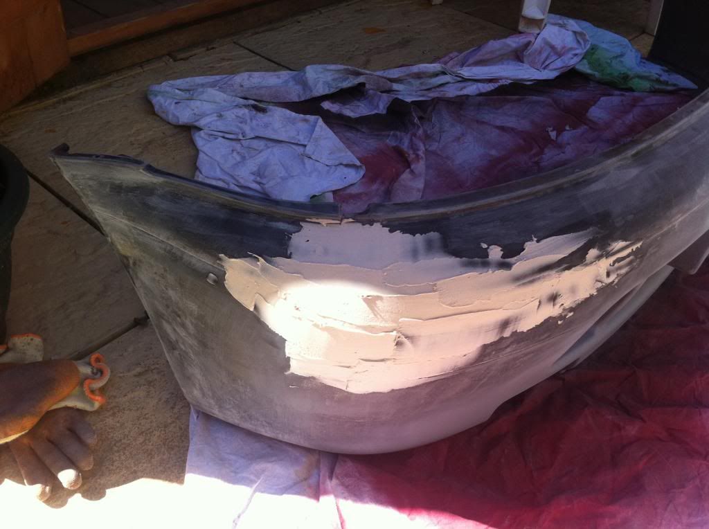

ive recently bought a new SR bumper from SR steve very badly damaged and fancied the challenge of repairing one :)

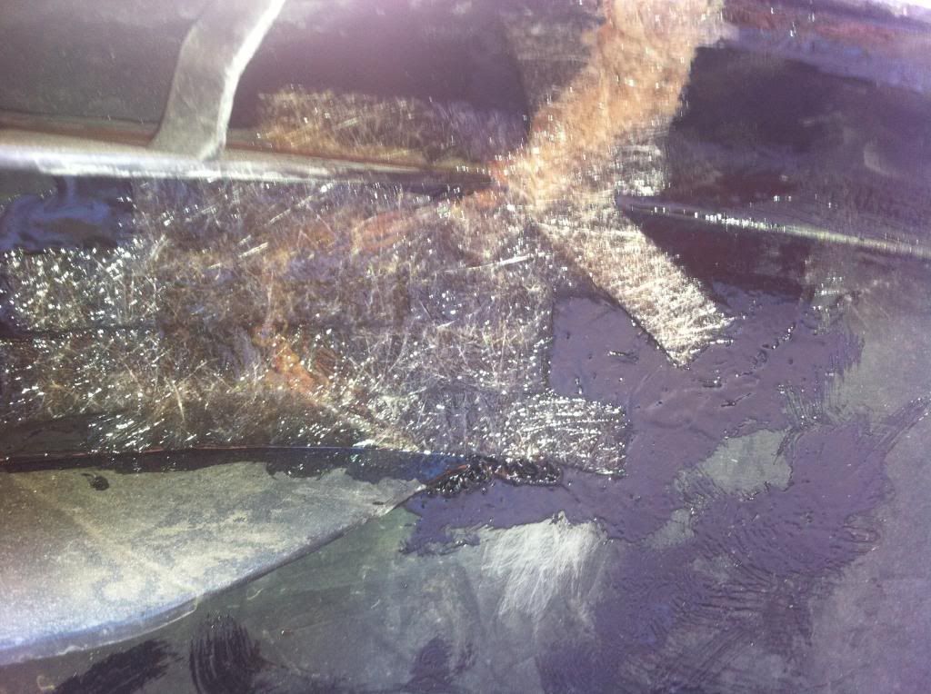

so got the fiber glass out and repaired all the cracks in the bumper about 5 in total one that even i thought couldnt be fixed.
flatted all the paint and filled the biggest crack with p38 easy sand no power tools in my shed ;)
sanded and shaped for a good few hours till the whole bumper looked like this...

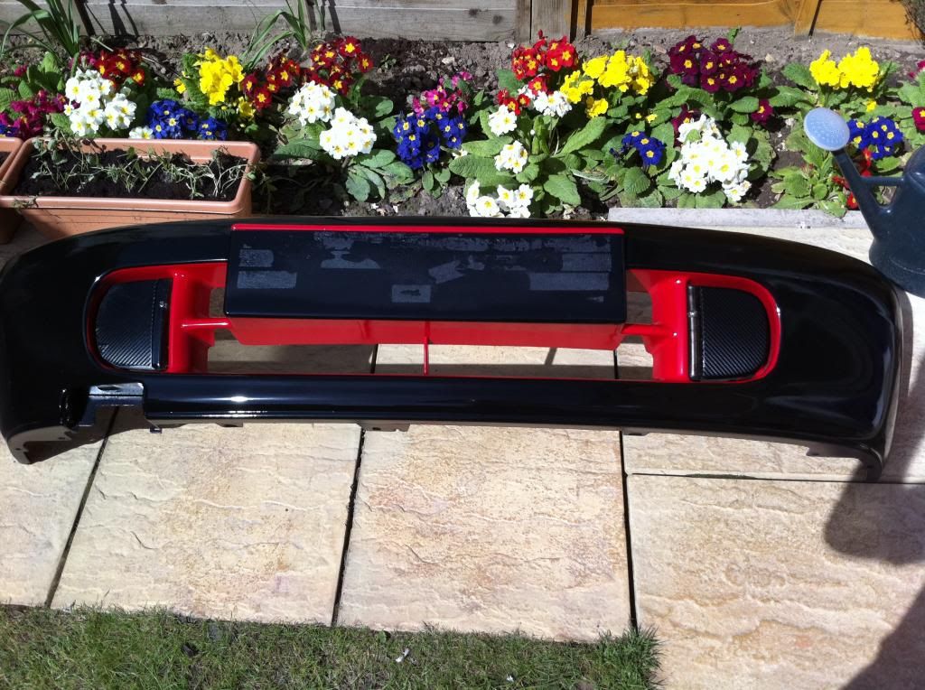

then there comes the questions from the mrs... youve got one of them can i have it on mine :D
and yes i guess she can so we spoke about paint and what she wanted to do... AJ4 all over or black poor person style?

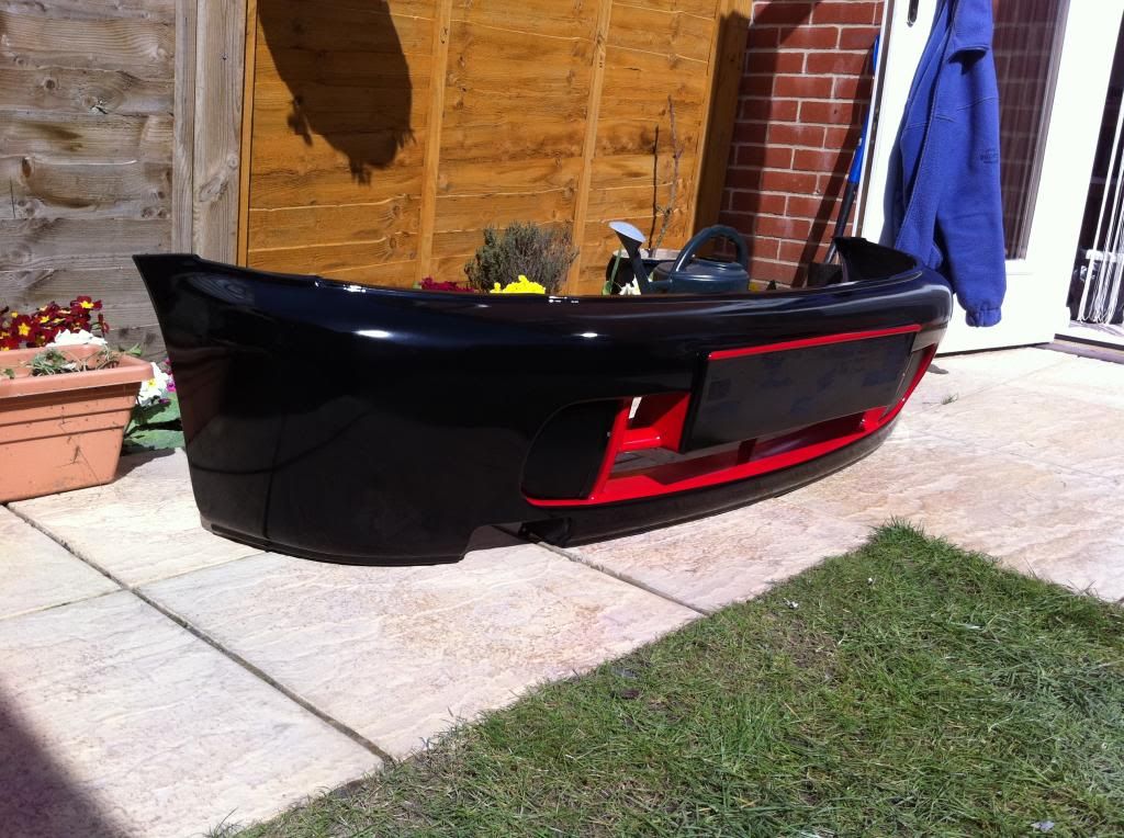

Finally after just 2 days and my garden to work in it was ready :)

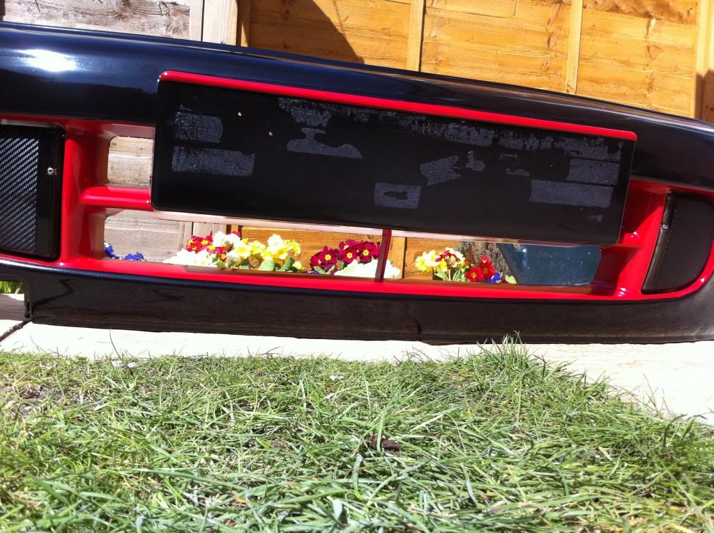

Gloss black with red insert i did try telling her colour coding is the way forward... but each to there own :)
pics will be up when its fitted... waiting for a day off now :(

your paint job is amazing! what do you use?
Oh stop it you will make me blush lol but thanks mate :)
What do I use... Honestly? 2 packs of project sand paper from halfords and rattle cans from halfords one garden some sun lots of swearing and shouting at the wind and patience :) thats it...

Does look amazing though, did you buffer it at the end at all? or is it just wet in the pictures because it looks bloody amazing.
I ask as i want to do mine, i was going to buy that one you have so i have a spare in case i mess up, but crappy funds :(. Wanted to try fabricate a jap stype one with a square plate
Ah wind, my arch nemesis.
Mine also and I'm sure many others on here haha
Nope not buffered or shined what you see is a gloss black bumper with red insert and 2 layers of lacquer all dry and shiny on it's own left to bake in the sun :)

Im just worried about it cracked after not to long :/
whats the best way, fibreglass?
What I do is drill a hole at the end of the crack this reduces tension and stops the crack moving any further. Then fibreglass the back side of the bumper as it's a pain in the rear to sand lol
Then body fill the crack lines smooth :) dust with primer to check it's super smooth :)

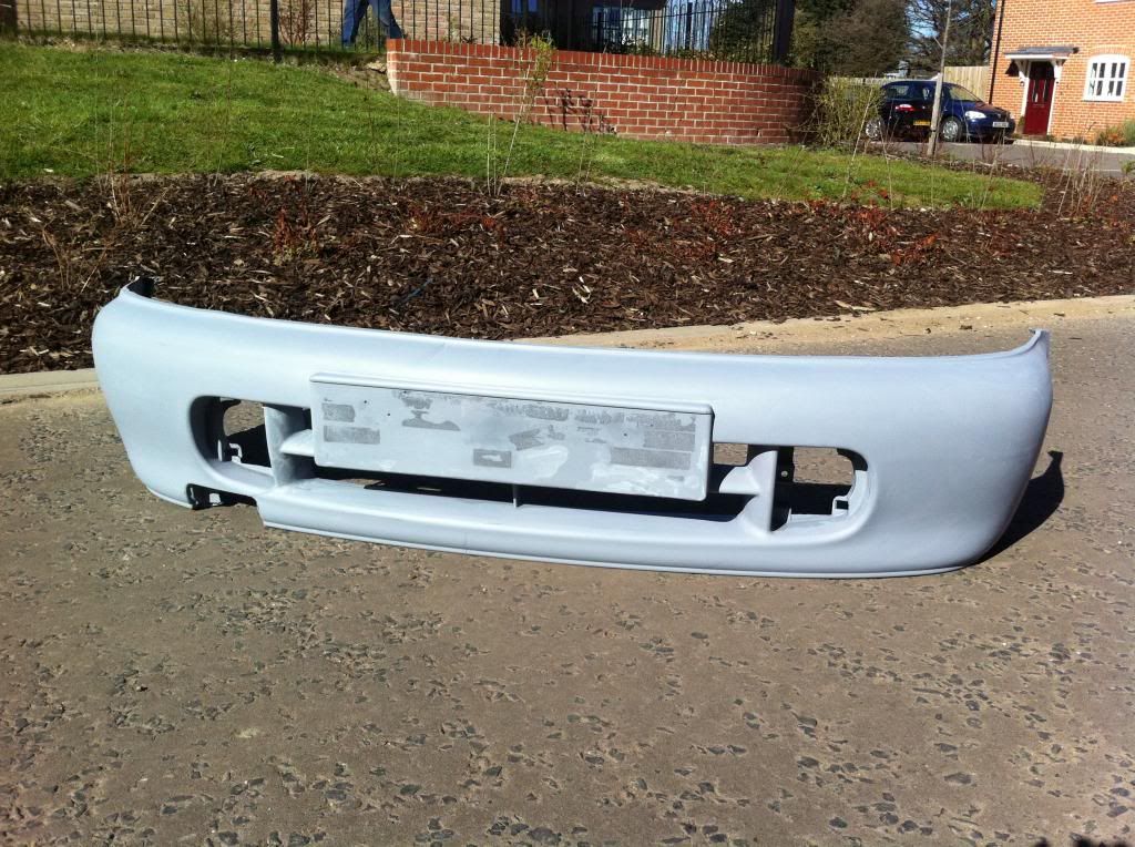

What about in terms of making a jap style bumper? whats the best way to cover up the big gaps as theyd be massive.
I drive a lot on A roads so prone to stone chips, and heavy winds, so itd have to be ultra strong
Fiberglass would hold up to that abuse chap a good few layers tho mind :) it's hideous stuff to work with but once you get the right skill going it's a worth while tool... Your only in cambridge right? I could come down and we could tackle that job together ive got plenty of useful plastic cards to bridge the gaps with?
