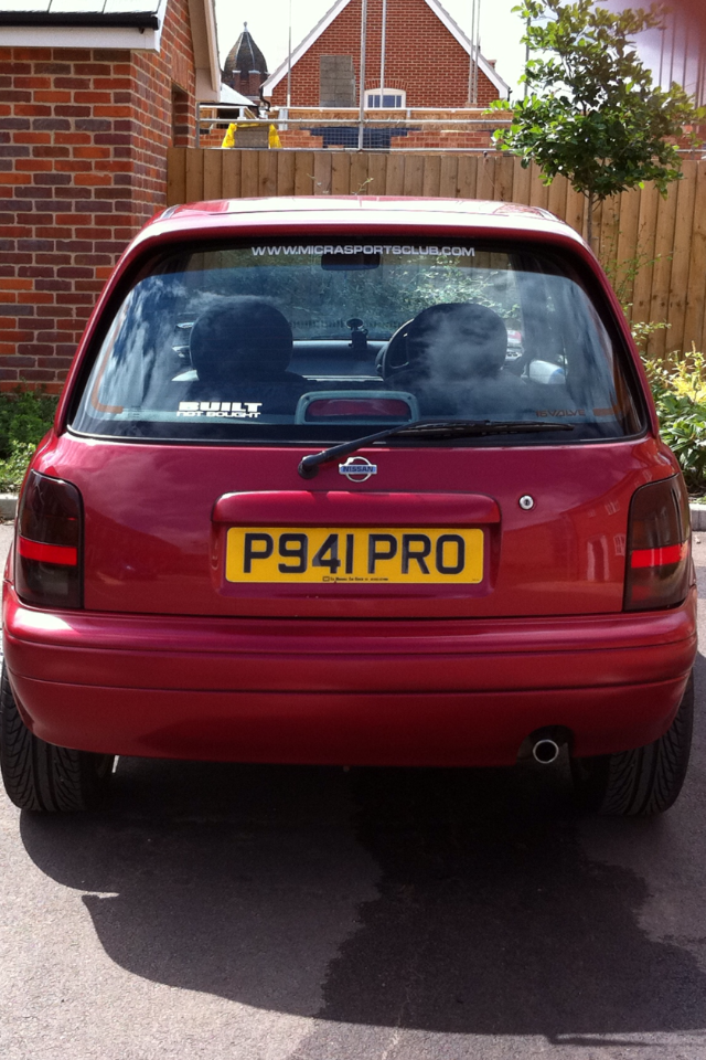

still got the rear window to do :) but not bad for my first ever attempt at tinting :p
Mate it looks good, my first attempt was good but the next morning it had fell off, purely because i didnt peel the other sheet off!! Good luck with the rear one though :)
Thanks mate... Wasn't to much trouble tbh
Hmm yes I'm aware of the trouble with the rear screen shape on the outside first then heat gun to remove wrinkles, roll it up and work it into place on the inside I'm sure I'll manage :)
Youtube videos FTW ;)...Great finish though, fairplay!
YouTube tinting videos have become the story of my life today more back window specials haha but it's all worth it for a top job :)
Ok so had 2 attempts at rear window and it's not happening I'll get a professional to do the rear haha

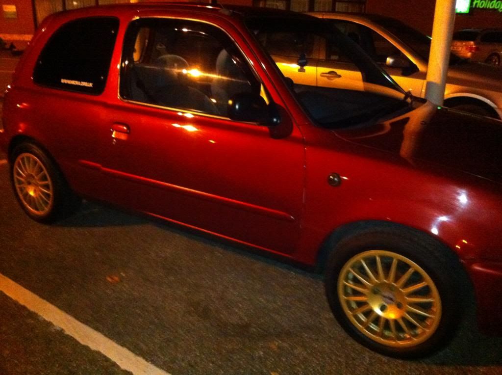

Project PROfect has now got alloys :D I picked them up 2nd hand need a good clean and respray in graphite Gray or gunmetal Gray as at the moment there gold and look horrible but 4 alloy wheels with new tyres for £80 cant complain :)
So here's the specs 7J et35 15s -195/50/15 uniroyle Rainsport 2 tyres...
Just need to really concentrate on lowering now, still can't decide how low to go.
Ok so heres the alloys i was talking about 195/50/15 no scrubbing at all and a straight forward fit.

oh and while im at it... ive had both comments on how bad the gold wheels look but also how nice they look... so
honestly speaking, do i stick with the gold or go graphite gray/ gunmetal gray?
Hmm when I first went to see the wheels I wasn't so sure on the golf but I guess they've grown on me slightly, I just didn't want it looking like some scooby wannabe :/ hmm I'll look into some 35mm springs then... Updated rear shocks? Or do I stick with standard?

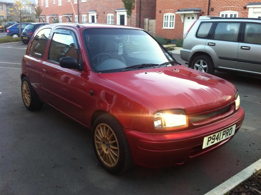

PROBLEM: Ok so driving home from work this morning I could smell smoke and thought nothing of it because I live in the country and there's always bonfires and other general fires... How wrong was I... Front headlight had caught fire and burnt out all the wiring fuses relays and melted the plastic connector that powers the bulb...
THE CAUSE: the 3 contacts in the connector had shorted and from what I can see melted it and the relay... But why fire? find out the the fuse was the wrong size.
Almost a total loss.
THE SOLUTION: scrapyard! fuses relays connector bulb and spare wiring £5
Close call, apparently a common fault anyone else had this issue?
usually caused by fitting high wattage bulbs, or not squeezing the sides of the connector when removing it (ie butchering it off :rolleyes:)

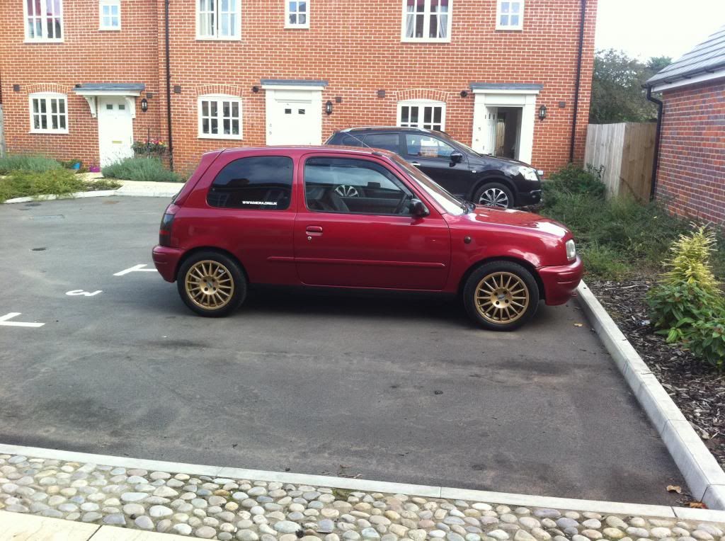

ok so heres what she looks like on 35mm springs... honestly imo it looks back to being standard might have to lose a coil or two ;)
Let me know what you all think :)

Ive said before about a recuring problem with my passenger headlight the adapter that connects to the bulb melts when people butcher them off in the cars past life... ive replaced it but sometimes it still refuses to come on and i have to open the bonnet and jiggle the wiring is there anyway of fixing this all connectors were soldered and heat shrinked.
Im all fresh out of ideas on anything else so suggestions for improvement are welcome and will be given much thought.
I might try to press those tree bulb connectors a bit tighter.
